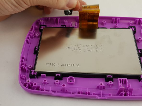

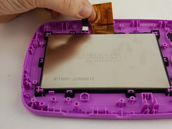

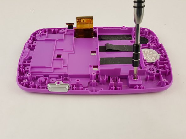

    1. Leapfrog LeapPad 3 Front Facing Camera Replacement, Front Facing Camera: crwdns2935265:010crwdnd2935265:01crwdnd2935265:02crwdne2935265:0 Leapfrog LeapPad 3 Front Facing Camera Replacement, Front Facing Camera: crwdns2935265:010crwdnd2935265:02crwdnd2935265:02crwdne2935265:0
      • Unscrew the eight 6.5 mm phillips screws from the plastic casing.
    2. Leapfrog LeapPad 3 Front Facing Camera Replacement: crwdns2935265:011crwdnd2935265:01crwdnd2935265:03crwdne2935265:0 Leapfrog LeapPad 3 Front Facing Camera Replacement: crwdns2935265:011crwdnd2935265:02crwdnd2935265:03crwdne2935265:0 Leapfrog LeapPad 3 Front Facing Camera Replacement: crwdns2935265:011crwdnd2935265:03crwdnd2935265:03crwdne2935265:0
      • Remove the covering with your hand to expose the front facing camera.
    3. Leapfrog LeapPad 3 Front Facing Camera Replacement: crwdns2935265:012crwdnd2935265:01crwdnd2935265:03crwdne2935265:0 Leapfrog LeapPad 3 Front Facing Camera Replacement: crwdns2935265:012crwdnd2935265:02crwdnd2935265:03crwdne2935265:0 Leapfrog LeapPad 3 Front Facing Camera Replacement: crwdns2935265:012crwdnd2935265:03crwdnd2935265:03crwdne2935265:0
      • Remove the front facing camera from the outer case.
