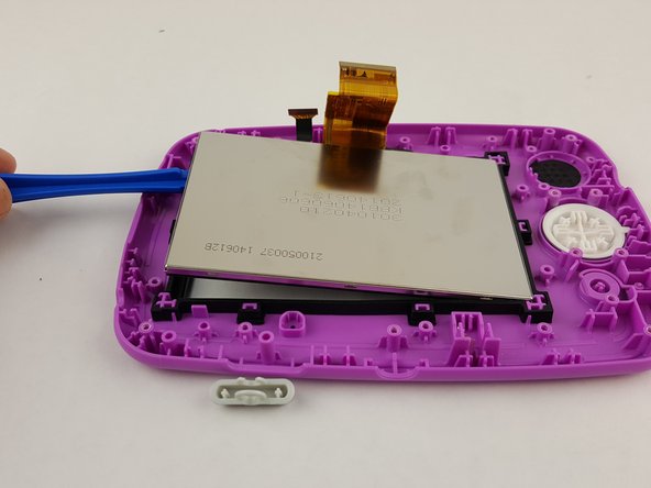

    1. Leapfrog LeapPad 3 Display Assembly Replacement, Display Assembly: crwdns2935265:010crwdnd2935265:01crwdnd2935265:02crwdne2935265:0 Leapfrog LeapPad 3 Display Assembly Replacement, Display Assembly: crwdns2935265:010crwdnd2935265:02crwdnd2935265:02crwdne2935265:0
      • Unscrew the eight 6.5mm Phillips #0 screws from the plastic casing.

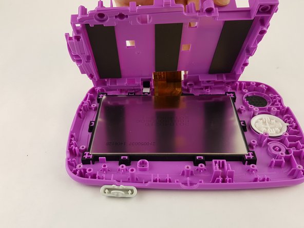

    2. Leapfrog LeapPad 3 Display Assembly Replacement: crwdns2935265:011crwdnd2935265:01crwdnd2935265:03crwdne2935265:0 Leapfrog LeapPad 3 Display Assembly Replacement: crwdns2935265:011crwdnd2935265:02crwdnd2935265:03crwdne2935265:0 Leapfrog LeapPad 3 Display Assembly Replacement: crwdns2935265:011crwdnd2935265:03crwdnd2935265:03crwdne2935265:0
      • Remove the covering with your hands to allow full view of the display assembly.

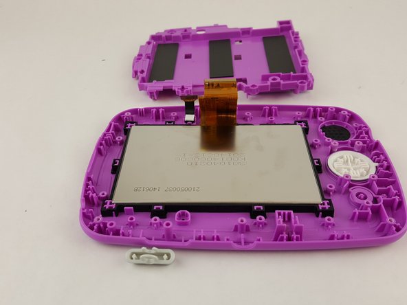

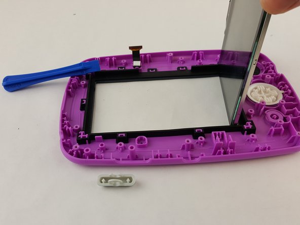

    3. Leapfrog LeapPad 3 Display Assembly Replacement: crwdns2935265:012crwdnd2935265:01crwdnd2935265:03crwdne2935265:0 Leapfrog LeapPad 3 Display Assembly Replacement: crwdns2935265:012crwdnd2935265:02crwdnd2935265:03crwdne2935265:0 Leapfrog LeapPad 3 Display Assembly Replacement: crwdns2935265:012crwdnd2935265:03crwdnd2935265:03crwdne2935265:0
      • Remove the display assembly from the black rubber sleeve carefully.
      • There is a specific orientation for the rubber sleeve so take note of its position.
