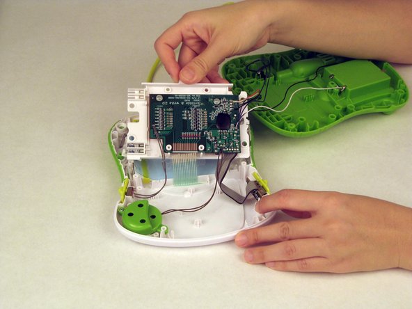

    • Using a Phillips #0 screwdriver, remove the two screws that secure the screen to the motherboard.
    • Set aside screws in a safe place.
    • Gently remove the motherboard to expose the display screen and eraser slider.

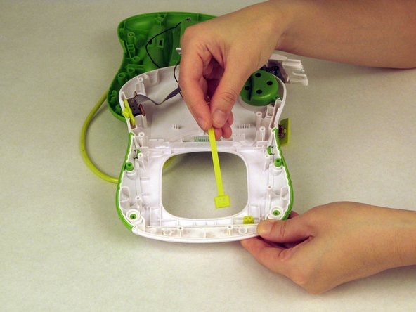

  5. LeapFrog Scribble and Write Eraser Slider Cleaning: crwdns2935265:05crwdnd2935265:01crwdnd2935265:01crwdne2935265:0
    • Carefully remove the display screen, leaving the eraser slider attached.
  6. LeapFrog Scribble and Write Eraser Slider Cleaning: crwdns2935265:06crwdnd2935265:01crwdnd2935265:02crwdne2935265:0 LeapFrog Scribble and Write Eraser Slider Cleaning: crwdns2935265:06crwdnd2935265:02crwdnd2935265:02crwdne2935265:0
    • Use the Phillips #0 screwdriver to remove the eraser slider.
  7. LeapFrog Scribble and Write Eraser Slider Cleaning: crwdns2935265:07crwdnd2935265:01crwdnd2935265:01crwdne2935265:0
    • Lastly, use a soft towel to clean the eraser slider, removing any debris.
