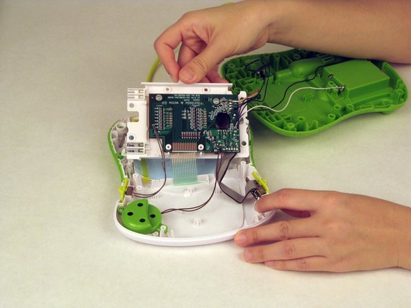

Your display screen may be unresponsive to the touch of your toy's stylus pen. Your toy may also display the wrong input. This could be happening because of a build up of debris. Your display screen will need to be cleaned or replaced.
    1. LeapFrog Scribble and Write Display Screen Replacement, Display Screen: crwdns2935265:01crwdnd2935265:01crwdnd2935265:02crwdne2935265:0 LeapFrog Scribble and Write Display Screen Replacement, Display Screen: crwdns2935265:01crwdnd2935265:02crwdnd2935265:02crwdne2935265:0
      • Turn your toy over.
      • Use a Phillips screwdriver to remove the nine case screws from the back of the toy.
      • Be careful to keep track of the screws.
    2. LeapFrog Scribble and Write Display Screen Replacement: crwdns2935265:02crwdnd2935265:01crwdnd2935265:01crwdne2935265:0
      • Carefully remove the back of the toy..
    3. LeapFrog Scribble and Write Display Screen Replacement: crwdns2935265:03crwdnd2935265:01crwdnd2935265:02crwdne2935265:0 LeapFrog Scribble and Write Display Screen Replacement: crwdns2935265:03crwdnd2935265:02crwdnd2935265:02crwdne2935265:0
      • Use a Philips screwdriver to remove the two screws attached to the motherboard.
      • Remove the motherboard.
    4. LeapFrog Scribble and Write Display Screen Replacement: crwdns2935265:04crwdnd2935265:01crwdnd2935265:02crwdne2935265:0 LeapFrog Scribble and Write Display Screen Replacement: crwdns2935265:04crwdnd2935265:02crwdnd2935265:02crwdne2935265:0
      • Remove the screen.
      • Remove the two pins from the bottom of the screen.

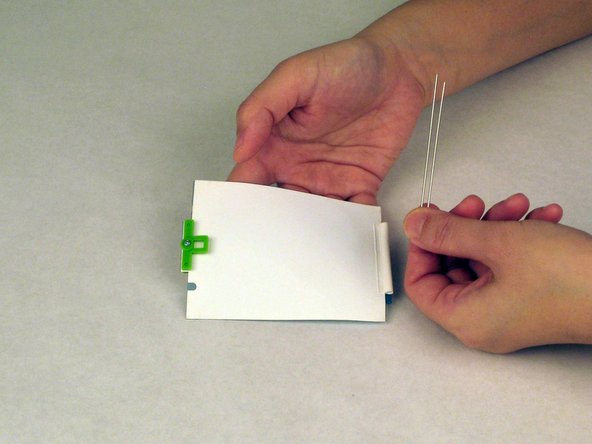

    5. LeapFrog Scribble and Write Display Screen Replacement: crwdns2935265:05crwdnd2935265:01crwdnd2935265:01crwdne2935265:0
      • Use a Phillips screwdriver to remove the screw from the green clip that holds the two screen layers together.

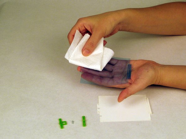

    6. LeapFrog Scribble and Write Display Screen Replacement: crwdns2935265:06crwdnd2935265:01crwdnd2935265:02crwdne2935265:0 LeapFrog Scribble and Write Display Screen Replacement: crwdns2935265:06crwdnd2935265:02crwdnd2935265:02crwdne2935265:0
      • Separate the blue and the white films.
      • Clean both films with paper towel.
      • Make sure there are no dirty spots before putting the films back together.
