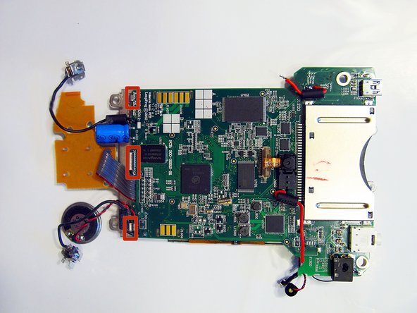

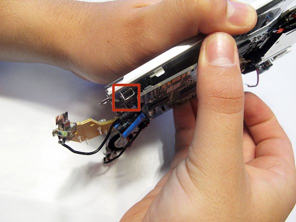

      • Lift the screen from the motherboard by pushing the board out from the three metal tabs.
      • Do not be too aggressive when separating the components, as the parts are still connected.
