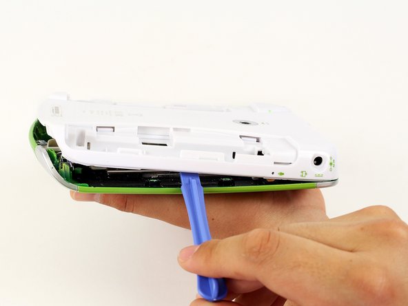

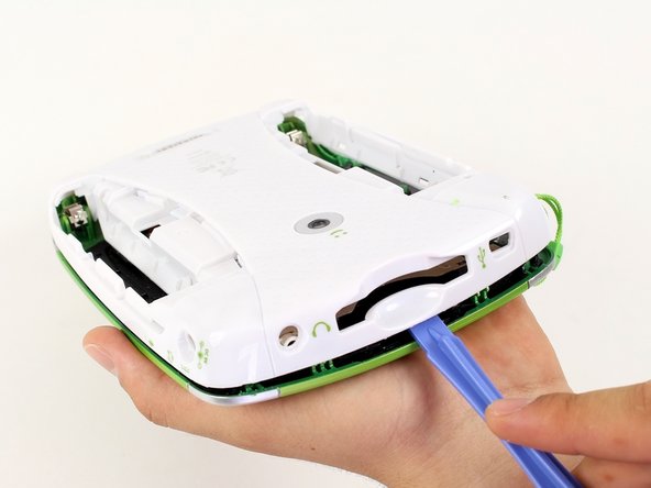

    2. LeapFrog LeapPad2 Explorer Front Camera Replacement: crwdns2935265:04crwdnd2935265:01crwdnd2935265:03crwdne2935265:0 LeapFrog LeapPad2 Explorer Front Camera Replacement: crwdns2935265:04crwdnd2935265:02crwdnd2935265:03crwdne2935265:0 LeapFrog LeapPad2 Explorer Front Camera Replacement: crwdns2935265:04crwdnd2935265:03crwdnd2935265:03crwdne2935265:0
      • Insert a plastic opening tool into the seam between the front and rear covers to detach the back cover from the rest of the device.
      • Move the plastic opening tool around the perimeter of the LeapPad2.
      • Lift up and remove the rear case from the tablet.
      • A butter knife can help when prying the device.

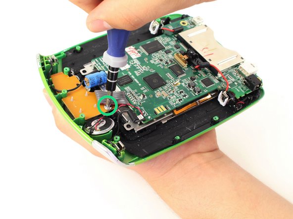

    1. LeapFrog LeapPad2 Explorer Front Camera Replacement, Front Cover: crwdns2935265:05crwdnd2935265:01crwdnd2935265:02crwdne2935265:0 LeapFrog LeapPad2 Explorer Front Camera Replacement, Front Cover: crwdns2935265:05crwdnd2935265:02crwdnd2935265:02crwdne2935265:0
      • Remove the following screws securing the front cover to the main device:
      • Three 6.0 mm Phillips screws
      • Three 7.0 mm Phillips screws
      • Two 10.0 mm Phillips screws
      • Three 7.0 mm Phillips screws (bulkier screw head than other 7.0 mm Phillips screws)
      • The white plastic component holding the speaker must be removed to reach the third 7.0 mm Phillips screw. Refer to Step 2.
    2. LeapFrog LeapPad2 Explorer Front Camera Replacement: crwdns2935265:06crwdnd2935265:01crwdnd2935265:02crwdne2935265:0 LeapFrog LeapPad2 Explorer Front Camera Replacement: crwdns2935265:06crwdnd2935265:02crwdnd2935265:02crwdne2935265:0
      • Unscrew the white plastic piece to expose the third 7.0 mm Phillips screw mentioned.
    3. LeapFrog LeapPad2 Explorer Front Camera Replacement: crwdns2935265:07crwdnd2935265:01crwdnd2935265:02crwdne2935265:0 LeapFrog LeapPad2 Explorer Front Camera Replacement: crwdns2935265:07crwdnd2935265:02crwdnd2935265:02crwdne2935265:0

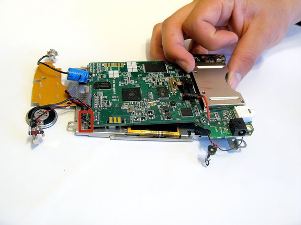

      • Desolder the through hole-components in power plugs on both sides of the device where the batteries were once connected.
      • Do not refer to the pictures in this step for correct soldering and de-soldering techniques. They are solely for illustration purposes.
      • For proper soldering and desoldering techniques reference How To Solder and Desolder Connections.
      • Soldering requires the iron to be at hot temperatures and can cause burns. Wear safety glasses as needed.
      • Be extremely careful with the cables in this step as they could melt, burn, or break.
    5. LeapFrog LeapPad2 Explorer Front Camera Replacement: crwdns2935265:09crwdnd2935265:01crwdnd2935265:02crwdne2935265:0 LeapFrog LeapPad2 Explorer Front Camera Replacement: crwdns2935265:09crwdnd2935265:02crwdnd2935265:02crwdne2935265:0
      • Pry the power cables from the device using your fingers or tweezers.
      • Now you should be able to lift up the front cover, leaving you with the motherboard and screen.

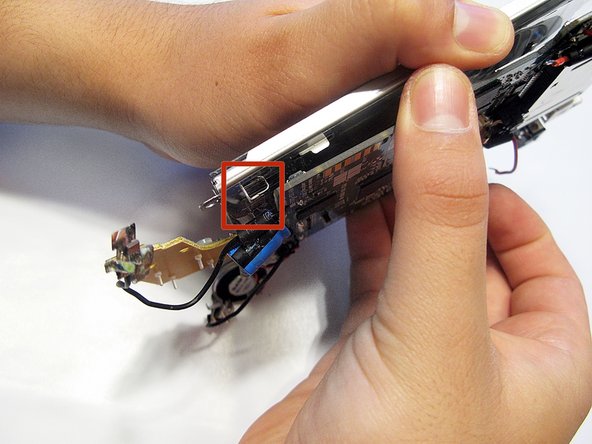

    1. LeapFrog LeapPad2 Explorer Front Camera Replacement, Front Camera: crwdns2935265:010crwdnd2935265:01crwdnd2935265:03crwdne2935265:0 LeapFrog LeapPad2 Explorer Front Camera Replacement, Front Camera: crwdns2935265:010crwdnd2935265:02crwdnd2935265:03crwdne2935265:0 LeapFrog LeapPad2 Explorer Front Camera Replacement, Front Camera: crwdns2935265:010crwdnd2935265:03crwdnd2935265:03crwdne2935265:0
      • Lift the screen from the motherboard by pulling the board out from the three metal tabs.
      • Do not be too aggressive when separating the components, as the parts are still connected.
    2. LeapFrog LeapPad2 Explorer Front Camera Replacement: crwdns2935265:011crwdnd2935265:01crwdnd2935265:01crwdne2935265:0
      • Separate the screen from the motherboard and lay the device's components flat open like a book.

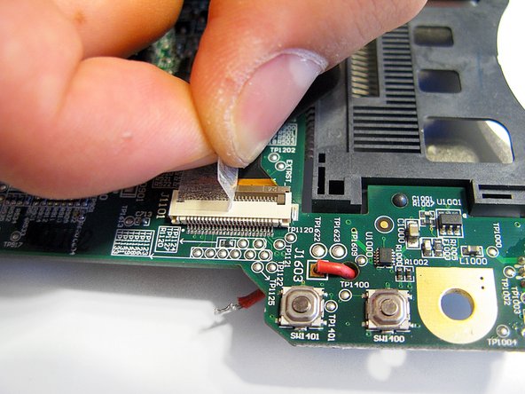

    3. LeapFrog LeapPad2 Explorer Front Camera Replacement: crwdns2935265:012crwdnd2935265:01crwdnd2935265:02crwdne2935265:0 LeapFrog LeapPad2 Explorer Front Camera Replacement: crwdns2935265:012crwdnd2935265:02crwdnd2935265:02crwdne2935265:0
      • Peel off tape covering the camera's connection ribbon to the circuit.
    4. LeapFrog LeapPad2 Explorer Front Camera Replacement: crwdns2935265:013crwdnd2935265:01crwdnd2935265:01crwdne2935265:0
      • To safely remove the ribbon cable, you must first pull up the retaining flap.
      • Failing to do this step could result in damage to the cable and/or connector.
    5. LeapFrog LeapPad2 Explorer Front Camera Replacement: crwdns2935265:014crwdnd2935265:01crwdnd2935265:01crwdne2935265:0
      • Gently pull outward, to remove the ribbon from the socket on the circuit board.
      • If the flap is up as shown in the picture, no force should be required to remove the ribbon cable.
