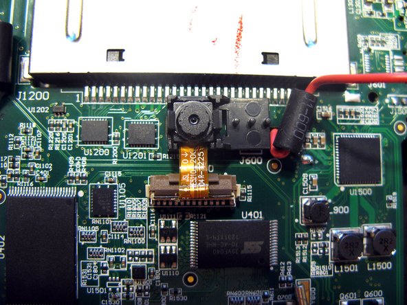

    1. LeapFrog LeapPad2 Explorer Back Camera Replacement, Back Camera: crwdns2935265:05crwdnd2935265:01crwdnd2935265:02crwdne2935265:0 LeapFrog LeapPad2 Explorer Back Camera Replacement, Back Camera: crwdns2935265:05crwdnd2935265:02crwdnd2935265:02crwdne2935265:0
      • Locate the back camera below the game cartridge.
    2. LeapFrog LeapPad2 Explorer Back Camera Replacement: crwdns2935265:06crwdnd2935265:01crwdnd2935265:02crwdne2935265:0 LeapFrog LeapPad2 Explorer Back Camera Replacement: crwdns2935265:06crwdnd2935265:02crwdnd2935265:02crwdne2935265:0
      • To safely remove the ribbon cable, first you must pull up the retaining flap.
      • Removing or reinserting the cable by brute force can damage it.
    3. LeapFrog LeapPad2 Explorer Back Camera Replacement: crwdns2935265:07crwdnd2935265:01crwdnd2935265:02crwdne2935265:0 LeapFrog LeapPad2 Explorer Back Camera Replacement: crwdns2935265:07crwdnd2935265:02crwdnd2935265:02crwdne2935265:0
      • Pull up using a thin plastic tool to disconnect the ribbon connecting the camera to the motherboard.
    4. LeapFrog LeapPad2 Explorer Back Camera Replacement: crwdns2935265:08crwdnd2935265:01crwdnd2935265:01crwdne2935265:0
      • Gently remove the back camera from your motherboard by pushing the black casing away from the camera.
