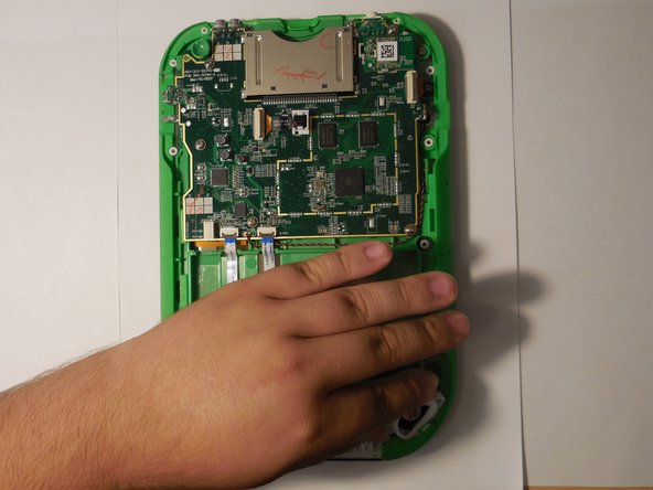

  5. LeapFrog LeapPad Ultra Repair Speaker Replacement: crwdns2935265:05crwdnd2935265:01crwdnd2935265:01crwdne2935265:0
    • Remove the hard plastic casing, exposing the motherboard and battery.
  6. LeapFrog LeapPad Ultra Repair Speaker Replacement: crwdns2935265:06crwdnd2935265:01crwdnd2935265:02crwdne2935265:0 LeapFrog LeapPad Ultra Repair Speaker Replacement: crwdns2935265:06crwdnd2935265:02crwdnd2935265:02crwdne2935265:0
    • Disconnect the battery using tweezers or your fingernails.
    • The battery is glued down, if available put some isopropyl alcohol around the edges of the battery to soften the glue.
    • Gently pry of the battery lose using a spudger or another thin prying tool.
    • Be careful, damaging/puncturing the battery may cause an explosion.

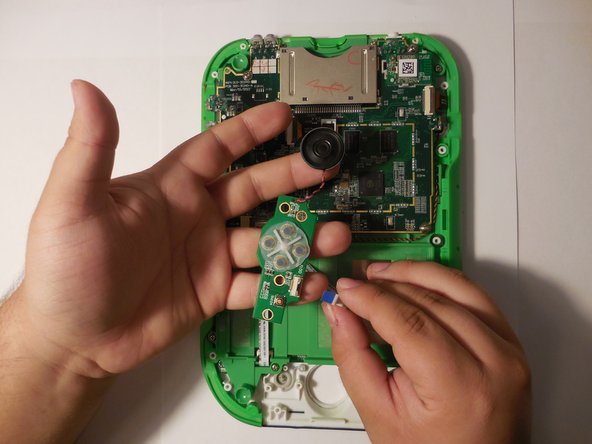

  7. LeapFrog LeapPad Ultra Repair Speaker Replacement, Speaker: crwdns2935265:07crwdnd2935265:01crwdnd2935265:01crwdne2935265:0
    • Find the screws on the bottom of the device holding down the button and speakers board.
  8. LeapFrog LeapPad Ultra Repair Speaker Replacement: crwdns2935265:08crwdnd2935265:01crwdnd2935265:02crwdne2935265:0 LeapFrog LeapPad Ultra Repair Speaker Replacement: crwdns2935265:08crwdnd2935265:02crwdnd2935265:02crwdne2935265:0
    • There should be a plastic covering over the speaker, carefully pull on the opposite side from the plastic clip holding it in place.
    • Excessive force can break the plastic clip, only use enough for to remove it gently
  9. LeapFrog LeapPad Ultra Repair Speaker Replacement: crwdns2935265:09crwdnd2935265:01crwdnd2935265:02crwdne2935265:0 LeapFrog LeapPad Ultra Repair Speaker Replacement: crwdns2935265:09crwdnd2935265:02crwdnd2935265:02crwdne2935265:0
    • Lift the button and speaker board, and turn it over, revealing the other side of the board.

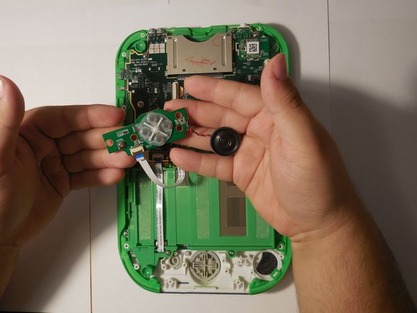

  10. LeapFrog LeapPad Ultra Repair Speaker Replacement: crwdns2935265:010crwdnd2935265:01crwdnd2935265:02crwdne2935265:0 LeapFrog LeapPad Ultra Repair Speaker Replacement: crwdns2935265:010crwdnd2935265:02crwdnd2935265:02crwdne2935265:0
    • Find the ribbon cable connection and with a small plastic tool flip the plastic holding it down up.
    • You can now safely remove the ribbon cable by gently pulling it out of the slot.
    • Trying to remove the cable with brute force will damage the cable.
