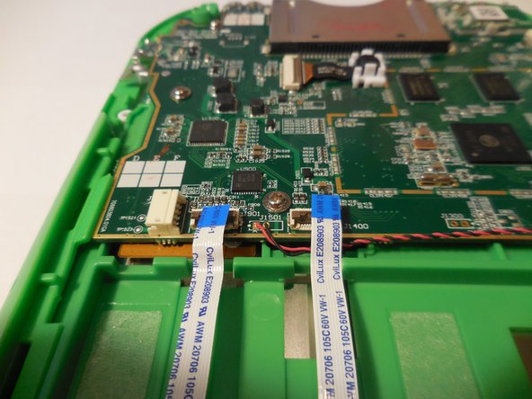

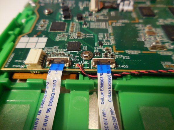

  7. LeapFrog LeapPad Ultra Repair Screen Replacement, Motherboard: crwdns2935265:07crwdnd2935265:01crwdnd2935265:03crwdne2935265:0 LeapFrog LeapPad Ultra Repair Screen Replacement, Motherboard: crwdns2935265:07crwdnd2935265:02crwdnd2935265:03crwdne2935265:0 LeapFrog LeapPad Ultra Repair Screen Replacement, Motherboard: crwdns2935265:07crwdnd2935265:03crwdnd2935265:03crwdne2935265:0
    • Disconnect the three wires that will be visible on top of the motherboard. The wires need to be disconnected by pulling them up vertically.

  9. LeapFrog LeapPad Ultra Repair Screen Replacement: crwdns2935265:09crwdnd2935265:01crwdnd2935265:03crwdne2935265:0 LeapFrog LeapPad Ultra Repair Screen Replacement: crwdns2935265:09crwdnd2935265:02crwdnd2935265:03crwdne2935265:0 LeapFrog LeapPad Ultra Repair Screen Replacement: crwdns2935265:09crwdnd2935265:03crwdnd2935265:03crwdne2935265:0
    • Lift the motherboard up exposing the fourth and final wire. Once you lift up the motherboard you will need to pull down on the wire to disconnect.

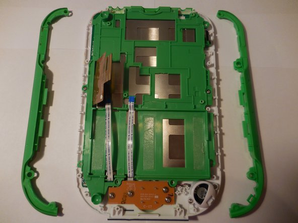

  11. LeapFrog LeapPad Ultra Repair Screen Replacement, Screen: crwdns2935265:011crwdnd2935265:01crwdnd2935265:02crwdne2935265:0 LeapFrog LeapPad Ultra Repair Screen Replacement, Screen: crwdns2935265:011crwdnd2935265:02crwdnd2935265:02crwdne2935265:0
    • Remove the side grips simply pulling them both vertically exposing eight screws.
  12. LeapFrog LeapPad Ultra Repair Screen Replacement: crwdns2935265:012crwdnd2935265:01crwdnd2935265:01crwdne2935265:0
    • Using the screwdriver with the PH1 bit, unscrew all nine of the exposed screws holding the plastic base down and remove the base.
