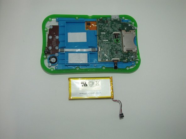

  5. LeapFrog LeapPad Ultimate Speaker Replacement: crwdns2935265:05crwdnd2935265:01crwdnd2935265:02crwdne2935265:0 LeapFrog LeapPad Ultimate Speaker Replacement: crwdns2935265:05crwdnd2935265:02crwdnd2935265:02crwdne2935265:0
    • Carefully remove the battery from the LeapPad. Use an opening tool or a plastic spudger to gain leverage, if needed.
    • Do not bend or puncture the battery.

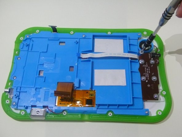

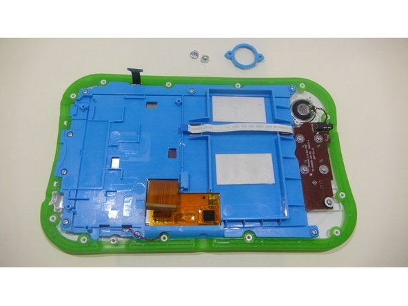

    • Remove the circular plastic speaker and the 2 screws a Phillips #1 screwdriver. Gently lift the cover off of the device.
  9. LeapFrog LeapPad Ultimate Speaker Replacement: crwdns2935265:09crwdnd2935265:01crwdnd2935265:02crwdne2935265:0 LeapFrog LeapPad Ultimate Speaker Replacement: crwdns2935265:09crwdnd2935265:02crwdnd2935265:02crwdne2935265:0
    • On the brown speaker board, you will see 5 more screws. Remove all 5 of these screws with the same Phillips #1 screwdriver.
    • Gently lift the speaker board, speaker, and attached ribbon cable from the device as one piece.
