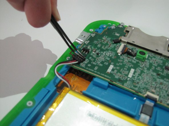

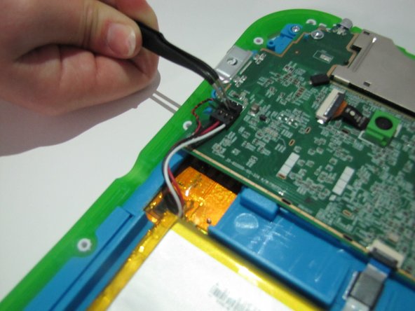

  3. LeapFrog LeapPad Ultimate LCD Screen Replacement, LCD Screen: crwdns2935265:03crwdnd2935265:01crwdnd2935265:03crwdne2935265:0 LeapFrog LeapPad Ultimate LCD Screen Replacement, LCD Screen: crwdns2935265:03crwdnd2935265:02crwdnd2935265:03crwdne2935265:0 LeapFrog LeapPad Ultimate LCD Screen Replacement, LCD Screen: crwdns2935265:03crwdnd2935265:03crwdnd2935265:03crwdne2935265:0
    • The segment connecting the battery to the motherboard will consist of red, white, and black wires.
    • There is a small notch on the segment. Use the curved tweezers to pull the notch in the direction of the battery. this will disconnect the battery from the motherboard.
    • The battery is the bright orange rectangle.
    • The motherboard is the large dark green surface.

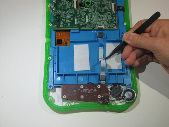

  4. LeapFrog LeapPad Ultimate LCD Screen Replacement: crwdns2935265:04crwdnd2935265:01crwdnd2935265:01crwdne2935265:0
    • Carefully remove the battery from its place and set aside.
    • Removing the battery will fully expose a white and blue ribbon cable that runs beneath the battery.
    • The ribbon cable must be disconnected from the motherboard and removed from the panel.
  5. LeapFrog LeapPad Ultimate LCD Screen Replacement: crwdns2935265:05crwdnd2935265:01crwdnd2935265:02crwdne2935265:0 LeapFrog LeapPad Ultimate LCD Screen Replacement: crwdns2935265:05crwdnd2935265:02crwdnd2935265:02crwdne2935265:0
    • The ZIF connector which connects the ribbon cable and the motherboard has a small flap on the top.
    • Use the curved tweezers to to flip the flap up.
    • Once it is disconnected, carefully pull the ribbon cable through the 2 black plastic arches holding it down.

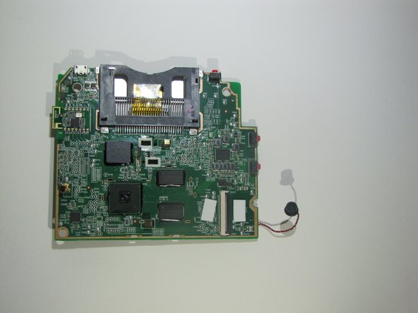

  8. LeapFrog LeapPad Ultimate LCD Screen Replacement: crwdns2935265:08crwdnd2935265:01crwdnd2935265:01crwdne2935265:0
    • Unscrew the 3 screws on the motherboard with a Phillips #1 screwdriver.
  9. LeapFrog LeapPad Ultimate LCD Screen Replacement: crwdns2935265:09crwdnd2935265:01crwdnd2935265:02crwdne2935265:0 LeapFrog LeapPad Ultimate LCD Screen Replacement: crwdns2935265:09crwdnd2935265:02crwdnd2935265:02crwdne2935265:0
    • Flip the motherboard over to expose the uderside.
    • There is a wide black ribbon with a swtich. Flip the switch and set aside the motherboard.

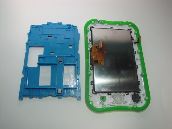

  10. LeapFrog LeapPad Ultimate LCD Screen Replacement: crwdns2935265:010crwdnd2935265:01crwdnd2935265:02crwdne2935265:0 LeapFrog LeapPad Ultimate LCD Screen Replacement: crwdns2935265:010crwdnd2935265:02crwdnd2935265:02crwdne2935265:0
    • Along the side of the blue panel are 6 screws. Unscrew each of the screws with a Phillips #1 screwdriver.
    • Remove the panel and the remainder of its contents and set aside.
  11. LeapFrog LeapPad Ultimate LCD Screen Replacement: crwdns2935265:011crwdnd2935265:01crwdnd2935265:01crwdne2935265:0
    • The screen is now exposed and can be removed and replaced.
