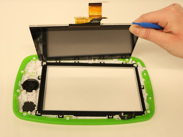

  16. LeapFrog LeapPad Platinum Screen Replacement, Touch Screen: crwdns2935265:016crwdnd2935265:01crwdnd2935265:01crwdne2935265:0
    • Remove the power and the volume buttons from their cradles.
    • This does not require any tool, just lift them out and put them in a secure place.
  17. LeapFrog LeapPad Platinum Screen Replacement: crwdns2935265:017crwdnd2935265:01crwdnd2935265:02crwdne2935265:0 LeapFrog LeapPad Platinum Screen Replacement: crwdns2935265:017crwdnd2935265:02crwdnd2935265:02crwdne2935265:0
    • Remove the eight 4.0 mm screws for the plastic backing that covers the screen.
    • Be certain to keep track of your screws.
    • The directional pad is now loose and can also be removed.
  18. LeapFrog LeapPad Platinum Screen Replacement: crwdns2935265:018crwdnd2935265:01crwdnd2935265:02crwdne2935265:0 LeapFrog LeapPad Platinum Screen Replacement: crwdns2935265:018crwdnd2935265:02crwdnd2935265:02crwdne2935265:0
    • Carefully lift out the plastic plate and set it aside.
  19. LeapFrog LeapPad Platinum Screen Replacement: crwdns2935265:019crwdnd2935265:01crwdnd2935265:02crwdne2935265:0 LeapFrog LeapPad Platinum Screen Replacement: crwdns2935265:019crwdnd2935265:02crwdnd2935265:02crwdne2935265:0
    • The screen is now completely accessible and can be lifted out of its cradle. Use the plastic spudger to safely and carefully lift the screen up.
    • Screens are very fragile so be sure to have a safe and secure place to put it, safely away from any magnetic devices.
