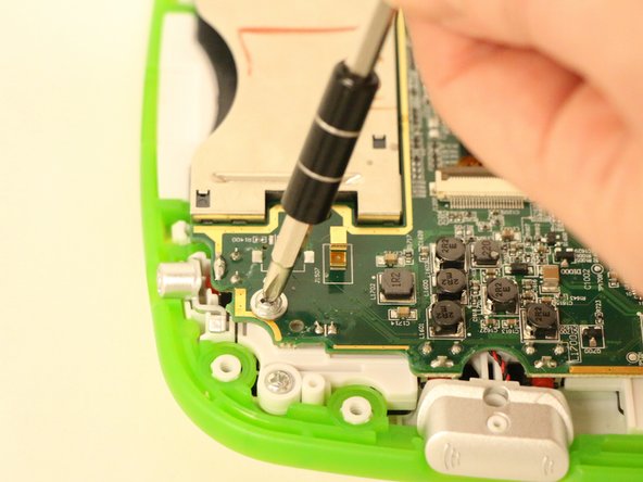

  9. LeapFrog LeapPad Platinum Motherboard Replacement: crwdns2935265:09crwdnd2935265:01crwdnd2935265:02crwdne2935265:0 LeapFrog LeapPad Platinum Motherboard Replacement: crwdns2935265:09crwdnd2935265:02crwdnd2935265:02crwdne2935265:0
    • Remove the three 4.0 mm Phillips screws located in the corners of the motherboard.
  10. LeapFrog LeapPad Platinum Motherboard Replacement: crwdns2935265:010crwdnd2935265:01crwdnd2935265:01crwdne2935265:0
    • Lift up the front edge of the motherboard.
    • Lift the volume-control button out of the device and set it aside.
  11. LeapFrog LeapPad Platinum Motherboard Replacement: crwdns2935265:011crwdnd2935265:01crwdnd2935265:01crwdne2935265:0
    • Gently tug upwards on the red and black twisted wires located near the button you just removed to release the black rubber base they are connected to from the device.
    • This does not take much force, so it is likely that this piece will pop out of place when initially lifting the motherboard.
  12. LeapFrog LeapPad Platinum Motherboard Replacement: crwdns2935265:012crwdnd2935265:01crwdnd2935265:02crwdne2935265:0 LeapFrog LeapPad Platinum Motherboard Replacement: crwdns2935265:012crwdnd2935265:02crwdnd2935265:02crwdne2935265:0
    • Rotate your device 180 degrees so the the motherboard is on your right-hand side and gently lift the front edge of the motherboard to reveal an orange sheet of plastic.
    • Disconnect the orange sheet from the motherboard by lifting the metal tab on the connector (as you did for the cables in steps 1 and 2), and lift the motherboard completely out of the device.
