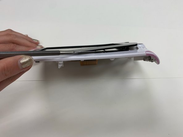

  11. LeapFrog LeapPad 32400 Screen Replacement: crwdns2935265:011crwdnd2935265:01crwdnd2935265:03crwdne2935265:0 LeapFrog LeapPad 32400 Screen Replacement: crwdns2935265:011crwdnd2935265:02crwdnd2935265:03crwdne2935265:0 LeapFrog LeapPad 32400 Screen Replacement: crwdns2935265:011crwdnd2935265:03crwdnd2935265:03crwdne2935265:0
    • Flip the front cover over so the front screen is visible.
    • Using an iFixit opening tool, pry off the front black plastic border. Start from the bottom of the black border near the large center button, then make your way around.
    • Only three of the four sides of the black border have to be removed from the white front cover in order to remove the screen.
    • Remove the screen from the device.
