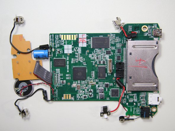

  19. LeapFrog LeapPad 2 Speaker Replacement, Motherboard: crwdns2935265:019crwdnd2935265:01crwdnd2935265:02crwdne2935265:0 LeapFrog LeapPad 2 Speaker Replacement, Motherboard: crwdns2935265:019crwdnd2935265:02crwdnd2935265:02crwdne2935265:0
    • The motherboard is now separated.

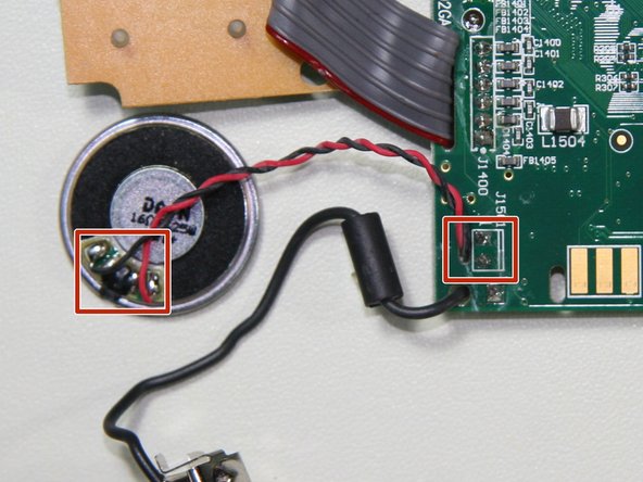

  20. LeapFrog LeapPad 2 Speaker Replacement, Speaker: crwdns2935265:020crwdnd2935265:01crwdnd2935265:02crwdne2935265:0 LeapFrog LeapPad 2 Speaker Replacement, Speaker: crwdns2935265:020crwdnd2935265:02crwdnd2935265:02crwdne2935265:0
    • Speaker wire terminal locations.
    • Desolder the speaker wire connections at one of the two terminal locations shown.
    • For proper soldering and desoldering techniques reference How To Solder and Desolder Connections.
    • Soldering requires the iron to be at hot temperatures and can cause burns. Wear safety glasses as needed.
    • Be extremely careful with the cables in this step as they could melt, burn, or break.
