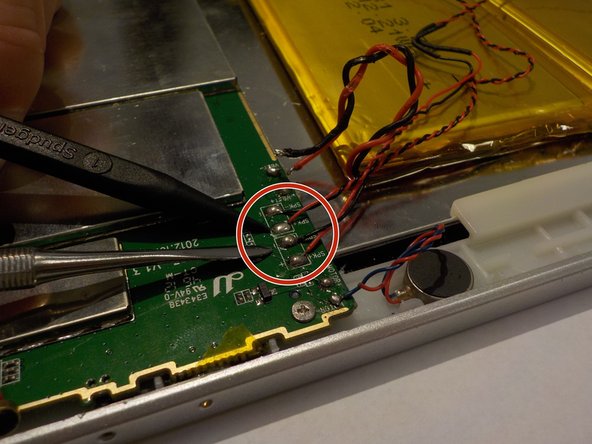

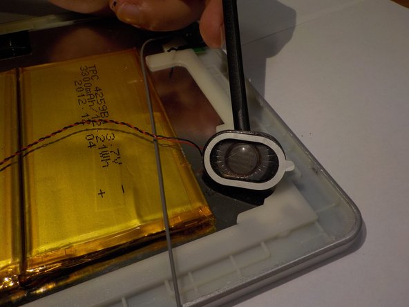

    • Use the spudger to pry both of the speakers from the tablet.
    • Follow both sets of speaker wires to the motherboard where they are connected.
    • Desolder the wire connections from the motherboard.
