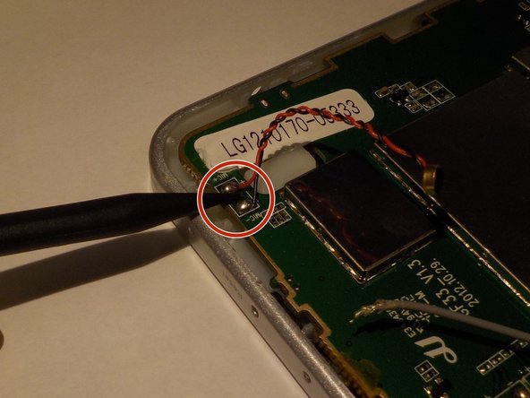

    • Orient your Leader Impression i10A-LE with the word "Impression" closest to you and the camera in the top left corner.
  2. Leader Impression i10A-LE Microphone Replacement: crwdns2935265:02crwdnd2935265:01crwdnd2935265:03crwdne2935265:0 Leader Impression i10A-LE Microphone Replacement: crwdns2935265:02crwdnd2935265:02crwdnd2935265:03crwdne2935265:0 Leader Impression i10A-LE Microphone Replacement: crwdns2935265:02crwdnd2935265:03crwdnd2935265:03crwdne2935265:0
    • Pry the back off by using plastic opening tools.
    • Using the plastic tools slide the flat end into the device.
    • Gently pry the back piece until you hear a popping noise.
    • Once the back is loose, remove it from the device and set aside.
  3. Leader Impression i10A-LE Microphone Replacement: crwdns2935265:03crwdnd2935265:01crwdnd2935265:02crwdne2935265:0 Leader Impression i10A-LE Microphone Replacement: crwdns2935265:03crwdnd2935265:02crwdnd2935265:02crwdne2935265:0
    • Disconnect the positive and negative battery leads.
    • Remove the microphone from plastic housing with the tweezers.
    • Desolder the positive (red) and negative (black) power leads.
