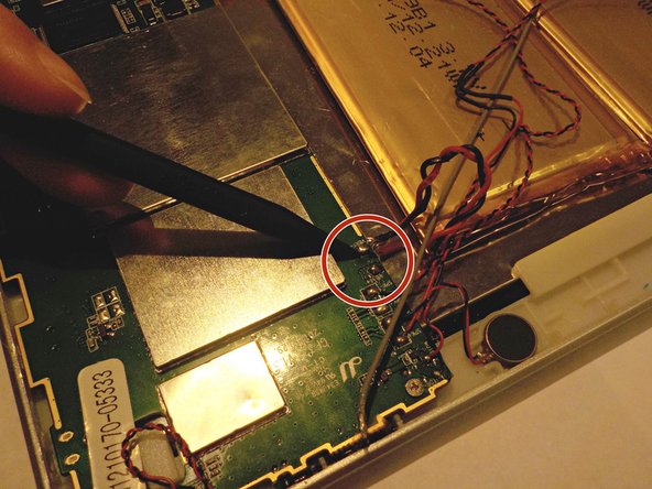

    • The battery pack is glued to the device.
    • Use a spudger to pry the battery pack from the glue.
    • Desolder the positive (red) and negative (black) power leads.
