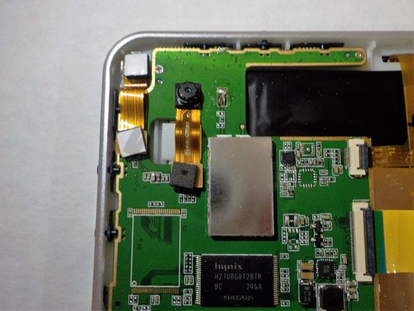

    • Start with your Leader Impression i10A-LE with the word "Impression" closest to you and the camera in the top left corner.
  2. Leader Impression i10A-LE Back Facing Camera Replacement: crwdns2935265:02crwdnd2935265:01crwdnd2935265:03crwdne2935265:0 Leader Impression i10A-LE Back Facing Camera Replacement: crwdns2935265:02crwdnd2935265:02crwdnd2935265:03crwdne2935265:0 Leader Impression i10A-LE Back Facing Camera Replacement: crwdns2935265:02crwdnd2935265:03crwdnd2935265:03crwdne2935265:0
    • Start by prying the back off by using plastic opening tools.
    • Using the plastic tools slide the flat end into the device.
    • Gently pry the back piece until you hear a popping noise.
    • Once the back is loose, remove it from the device and set aside.

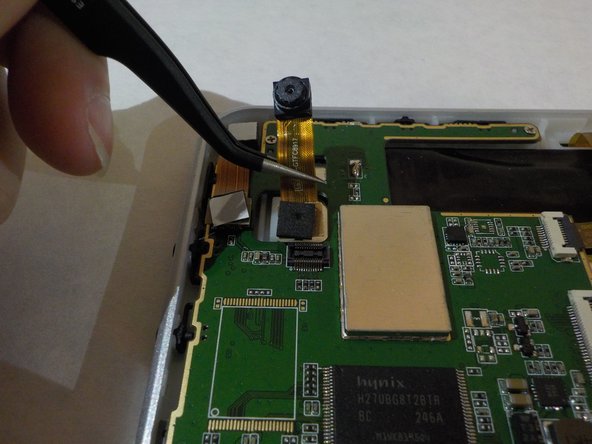

    • Once the back is off, locate the back facing camera.
    • The camera will be in the top left corner.

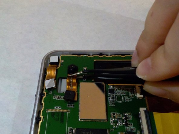

    • Using the precision tweezers that are bent, gently grab the strip below the camera.
    • slowly lift up until the camera lifts from its spot.

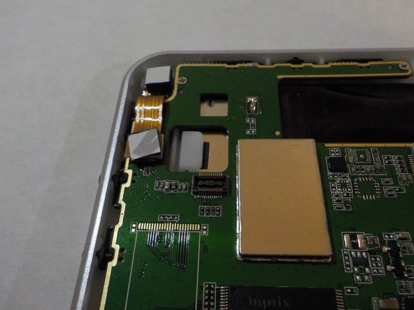

    • Continue slowly lifting with the bent precision tweezers.
    • The bottom half of the camera strip will pop out.
