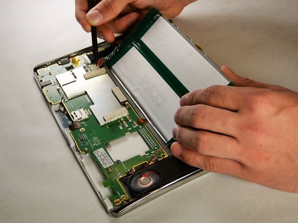

  4. Le Pan S Volume Rocker Replacement: crwdns2935265:04crwdnd2935265:01crwdnd2935265:02crwdne2935265:0 Le Pan S Volume Rocker Replacement: crwdns2935265:04crwdnd2935265:02crwdnd2935265:02crwdne2935265:0
    • Disconnect the battery from the circuitry and lay it out of the way.
    • The best method to complete this is to pull the bundled cable connector out with your hands. Pull towards the wires and away from the electrical board. Use the spudger to further coax the cable out.
    • If you are replacing your battery, make sure to dispose of it properly.
