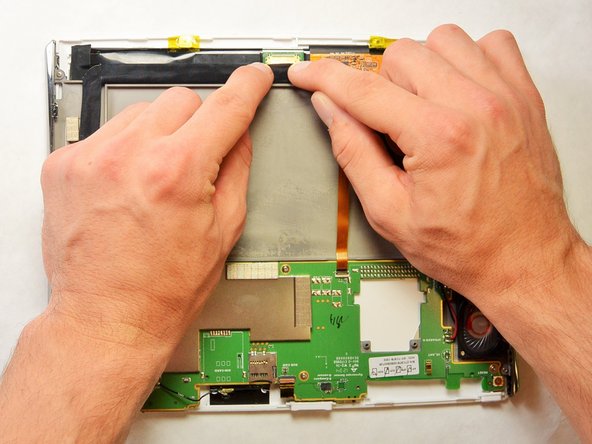

  5. Le Pan S Screen Replacement, Screen: crwdns2935265:05crwdnd2935265:01crwdnd2935265:01crwdne2935265:0
    • Remove the tape covering the end of the flat ribbon cable.
  6. Le Pan S Screen Replacement: crwdns2935265:06crwdnd2935265:01crwdnd2935265:02crwdne2935265:0 Le Pan S Screen Replacement: crwdns2935265:06crwdnd2935265:02crwdnd2935265:02crwdne2935265:0
    • Disconnect the display cable connector by gently pulling the white connection head out of its base.
    • Repeat for the cable's other end attached near the top of the tablet.
  7. Le Pan S Screen Replacement: crwdns2935265:07crwdnd2935265:01crwdnd2935265:01crwdne2935265:0
    • Disconnect the flat ribbon cable by disconnecting the zero insertion force (ZIF) connector.
    • This can be done by using a plastic opening tool, spudger, or fingernail to lift the retaining flap.

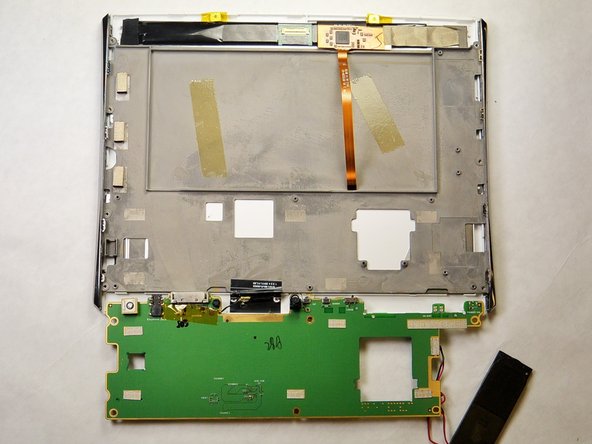

    • Remove the six 2.5 mm Phillips #00 screws securing the green electrical board.
  9. Le Pan S Screen Replacement: crwdns2935265:09crwdnd2935265:01crwdnd2935265:01crwdne2935265:0
    • Use the spudger to remove the vibration controller.
  10. Le Pan S Screen Replacement: crwdns2935265:010crwdnd2935265:01crwdnd2935265:01crwdne2935265:0
    • Remove the four 3.5 mm Phillips #00 screws holding the speakers in place.
  11. Le Pan S Screen Replacement: crwdns2935265:011crwdnd2935265:01crwdnd2935265:02crwdne2935265:0 Le Pan S Screen Replacement: crwdns2935265:011crwdnd2935265:02crwdnd2935265:02crwdne2935265:0
    • Flip the green electrical board back so that the screen is separated from the green board.
    • Be careful not to break the Wi-Fi antenna cable that is still soldered to the plastic casing.

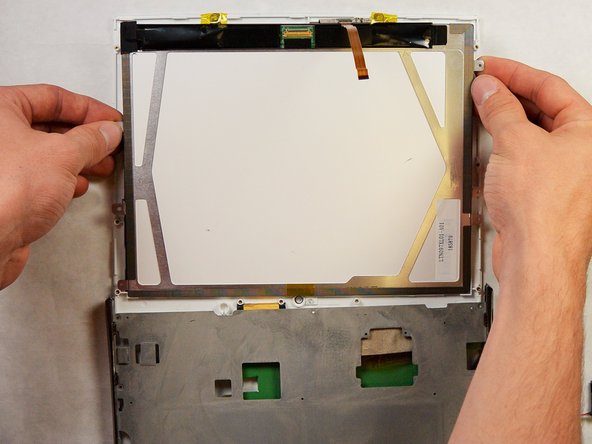

    • Take the gray backing off of the screen so that only the back of the LCD display is showing.
  14. Le Pan S Screen Replacement: crwdns2935265:014crwdnd2935265:01crwdnd2935265:01crwdne2935265:0
    • Remove the LCD display by lifting up carefully.
    • Place the display in an area where it will not be damaged.
