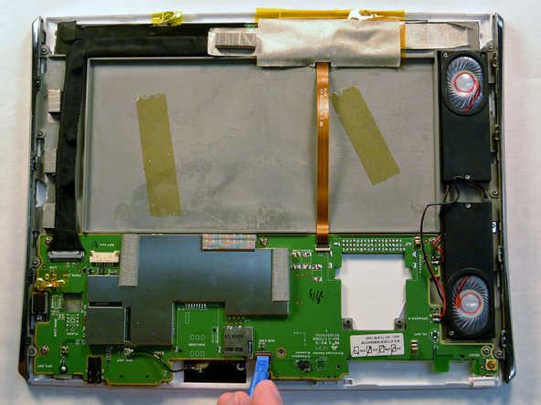

  5. Le Pan S Camera Replacement, Camera: crwdns2935265:05crwdnd2935265:01crwdnd2935265:01crwdne2935265:0
    • Remove the four 3.5 mm Phillips #00 screws from the circuit board near the bottom of the tablet.
  6. Le Pan S Camera Replacement: crwdns2935265:06crwdnd2935265:01crwdnd2935265:01crwdne2935265:0
    • Lift and pull the volume rocker up so it is out of the way of the camera.

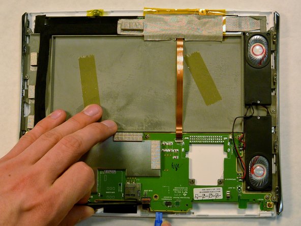

  7. Le Pan S Camera Replacement: crwdns2935265:07crwdnd2935265:01crwdnd2935265:02crwdne2935265:0 Le Pan S Camera Replacement: crwdns2935265:07crwdnd2935265:02crwdnd2935265:02crwdne2935265:0
    • Remove the zero insertion force connector (ZIF) by using a plastic opening tool, spudger, or fingernail to lift retaining flap.
  8. Le Pan S Camera Replacement: crwdns2935265:08crwdnd2935265:01crwdnd2935265:02crwdne2935265:0 Le Pan S Camera Replacement: crwdns2935265:08crwdnd2935265:02crwdnd2935265:02crwdne2935265:0
    • Slightly lift up the green electrical board and pull out the camera.
