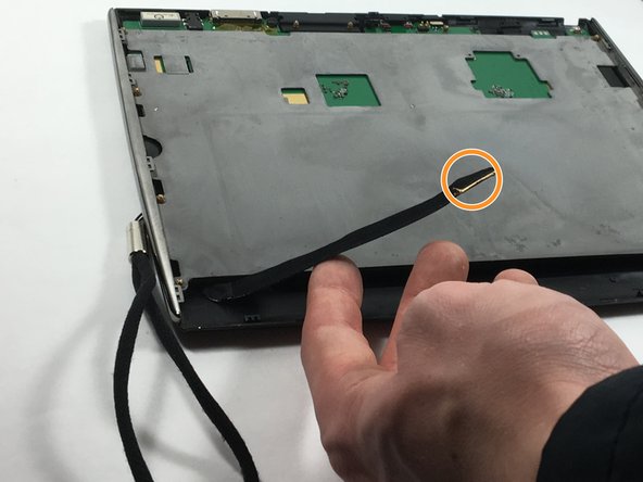

  4. Le Pan II Charging Port Replacement: crwdns2935265:04crwdnd2935265:01crwdnd2935265:01crwdne2935265:0
    • Remove grey metal backing from screen.
  5. Le Pan II Charging Port Replacement: crwdns2935265:05crwdnd2935265:01crwdnd2935265:01crwdne2935265:0
    • Flip the tablet so the screen is facing upward, and use the metal spudger to pry apart the screen from the side pieces.
  6. Le Pan II Charging Port Replacement: crwdns2935265:06crwdnd2935265:01crwdnd2935265:01crwdne2935265:0
    • Lift and carefully remove the LCD display from the front cover.
