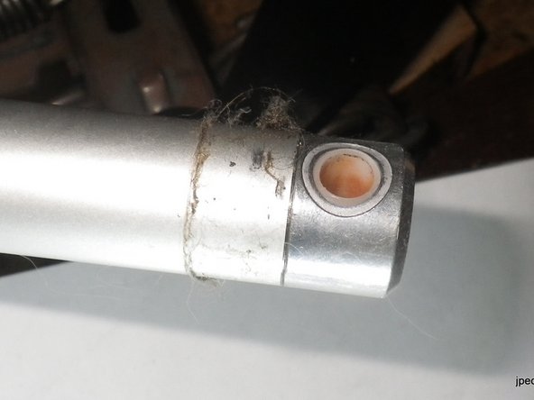

  1. Lazy boy chair powered lift mechanism, the piece that connects from the linear actuator to the lifting part for the leg lift: crwdns2935265:01crwdnd2935265:01crwdnd2935265:02crwdne2935265:0 Lazy boy chair powered lift mechanism, the piece that connects from the linear actuator to the lifting part for the leg lift: crwdns2935265:01crwdnd2935265:02crwdnd2935265:02crwdne2935265:0
    • Pictured the broken connector inside the linear actuator. To the right is the lifting part it was connected to.
    • Next picture is the linear actuator and where it is connected at the other end.

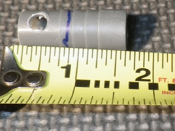

  2. Lazy boy chair powered lift mechanism: crwdns2935265:02crwdnd2935265:01crwdnd2935265:03crwdne2935265:0 Lazy boy chair powered lift mechanism: crwdns2935265:02crwdnd2935265:02crwdnd2935265:03crwdne2935265:0 Lazy boy chair powered lift mechanism: crwdns2935265:02crwdnd2935265:03crwdnd2935265:03crwdne2935265:0
    • Using a junior hack saw blade to cut notches in the broken connector, don't cut too deep, just enough so that the pieces could be pried out, the connector had some adhesive on it so that the part could not be unscrewed.
  3. Lazy boy chair powered lift mechanism, Measuring for a replacement part.: crwdns2935265:03crwdnd2935265:01crwdnd2935265:02crwdne2935265:0 Lazy boy chair powered lift mechanism, Measuring for a replacement part.: crwdns2935265:03crwdnd2935265:02crwdnd2935265:02crwdne2935265:0
    • This is what the manufactured part looks like, it is made of metal, it is threaded and has a 1/4 inch bushing at the other end for the locking pin.

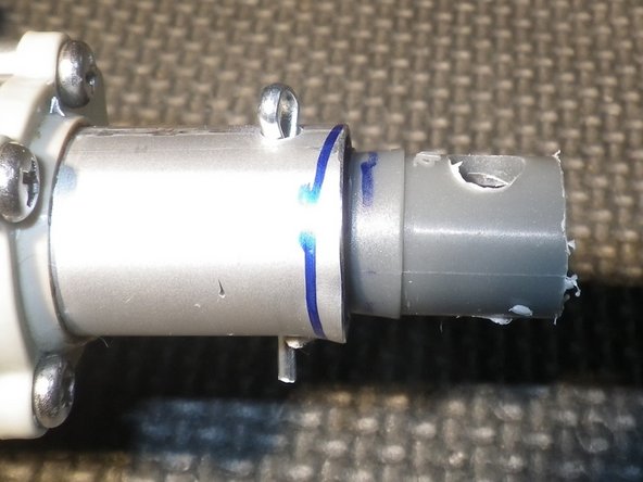

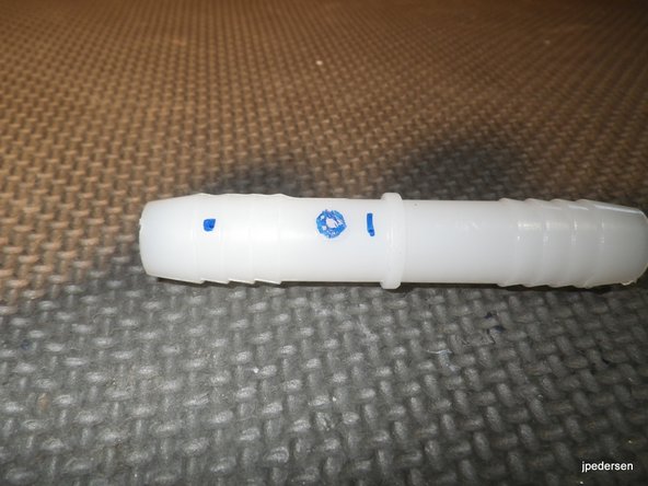

  4. Lazy boy chair powered lift mechanism, The repair part, home made: crwdns2935265:04crwdnd2935265:01crwdnd2935265:03crwdne2935265:0 Lazy boy chair powered lift mechanism, The repair part, home made: crwdns2935265:04crwdnd2935265:02crwdnd2935265:03crwdne2935265:0 Lazy boy chair powered lift mechanism, The repair part, home made: crwdns2935265:04crwdnd2935265:03crwdnd2935265:03crwdne2935265:0
    • The white connector is made out of nylon and is what I used for the fix, the gray connector was made out of polypropylene, it failed on the first test after the initial repair, It was used as a template for the repair with the nylon piece that continues to work well, day after day since I put it in.
    • The nylon is self lubricating so there is no need for an additional bushing for the connector pin.
  5. Lazy boy chair powered lift mechanism, Ther repair part continued: crwdns2935265:05crwdnd2935265:01crwdnd2935265:02crwdne2935265:0 Lazy boy chair powered lift mechanism, Ther repair part continued: crwdns2935265:05crwdnd2935265:02crwdnd2935265:02crwdne2935265:0
    • The "new" part had a 1/4inch hole drilled into one end of it using measurements from the other manufactured part. The barbed part was then inserted into the threaded end and since it could not be tightened, I drilled an 1/8 inch hole through the hole assembly and inserted a cotter pin to hold ti in place.

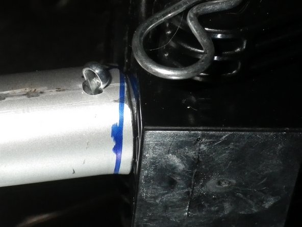

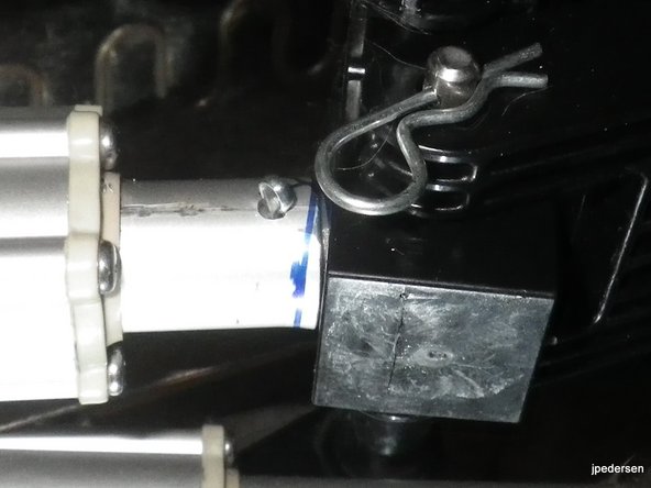

  6. Lazy boy chair powered lift mechanism, Installing the "new" piece: crwdns2935265:06crwdnd2935265:01crwdnd2935265:03crwdne2935265:0 Lazy boy chair powered lift mechanism, Installing the "new" piece: crwdns2935265:06crwdnd2935265:02crwdnd2935265:03crwdne2935265:0 Lazy boy chair powered lift mechanism, Installing the "new" piece: crwdns2935265:06crwdnd2935265:03crwdnd2935265:03crwdne2935265:0
    • The linear actuator is reinstalled and connected to the lifting mechanism.
