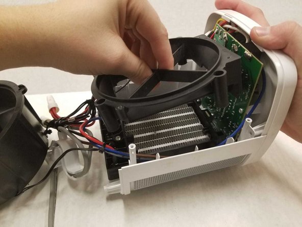

  4. Lasko CD08200 Fuse Replacement: crwdns2935265:04crwdnd2935265:01crwdnd2935265:03crwdne2935265:0 Lasko CD08200 Fuse Replacement: crwdns2935265:04crwdnd2935265:02crwdnd2935265:03crwdne2935265:0 Lasko CD08200 Fuse Replacement: crwdns2935265:04crwdnd2935265:03crwdnd2935265:03crwdne2935265:0
    • Remove the four 14mm screws housing the fan using the Phillips #2 screwdriver.
    • Remove the top of the fan housing with the fan attached and place it on the table.
  5. Lasko CD08200 Fuse Replacement, Fuse: crwdns2935265:05crwdnd2935265:01crwdnd2935265:02crwdne2935265:0 Lasko CD08200 Fuse Replacement, Fuse: crwdns2935265:05crwdnd2935265:02crwdnd2935265:02crwdne2935265:0
    • Remove the four 14mm screws housing the fan base using the Phillips #2 screwdriver.
    • Remove the fan base from the device.

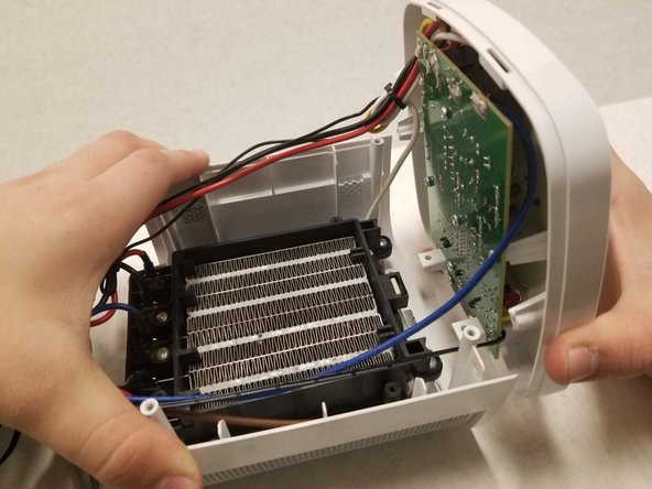

  6. Lasko CD08200 Fuse Replacement: crwdns2935265:06crwdnd2935265:01crwdnd2935265:03crwdne2935265:0 Lasko CD08200 Fuse Replacement: crwdns2935265:06crwdnd2935265:02crwdnd2935265:03crwdne2935265:0 Lasko CD08200 Fuse Replacement: crwdns2935265:06crwdnd2935265:03crwdnd2935265:03crwdne2935265:0
    • Remove the four 14mm screws housing the top panel using the Phillips #2 screwdriver.
    • Remove the top panel from the device.

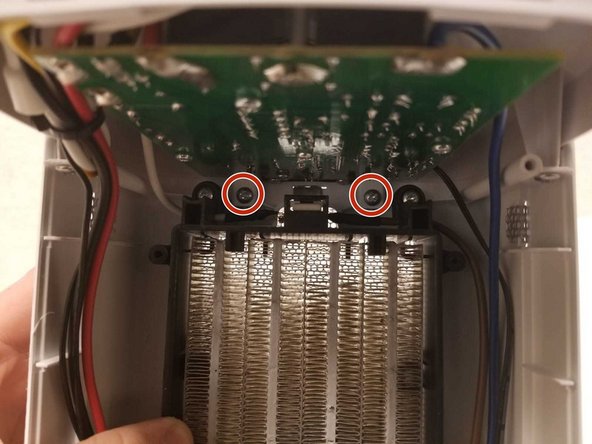

  7. Lasko CD08200 Fuse Replacement: crwdns2935265:07crwdnd2935265:01crwdnd2935265:01crwdne2935265:0
    • Remove the four 14mm screws housing the motherboard to the top panel using the Phillips #2 screwdriver.
    • Remove the motherboard from the top panel.
    • When reassembling, align the mainboard to the legs of the front panel as shown in the images. Screw in the first screw in the center of the mainboard.

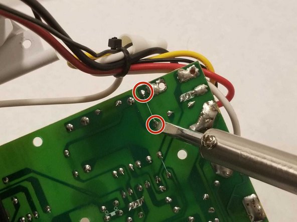

  8. Lasko CD08200 Fuse Replacement: crwdns2935265:08crwdnd2935265:01crwdnd2935265:02crwdne2935265:0 Lasko CD08200 Fuse Replacement: crwdns2935265:08crwdnd2935265:02crwdnd2935265:02crwdne2935265:0
    • Solder the two points on the back of the motherboard to release the fuse on the front.
    • Remove the fuse from the motherboard.

This is a very clearly written and beautifully photographed repair description. Thank you!
The only other information I need is a detailed description of the fuse so I can have a replacement ready to install when I begin the repair. Would you be willing to provide this information?
Thanks very much!
Jamie Wolf - crwdns2934203:0crwdne2934203:0
Salutations!
I'm afraid that neither I or my colleagues have no information on the fuse replaced on this guide. Perhaps an electrician with a careful eye may be able to help determine which fuse is required for this guide.
Best of luck on repairing your Lasko!
