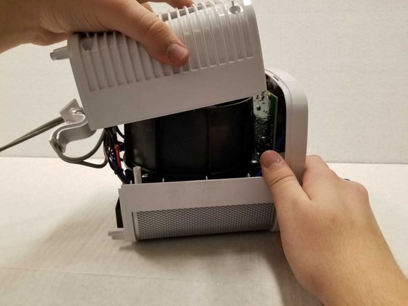

  3. Lasko CD08200 Fan Replacement: crwdns2935265:03crwdnd2935265:01crwdnd2935265:03crwdne2935265:0 Lasko CD08200 Fan Replacement: crwdns2935265:03crwdnd2935265:02crwdnd2935265:03crwdne2935265:0 Lasko CD08200 Fan Replacement: crwdns2935265:03crwdnd2935265:03crwdnd2935265:03crwdne2935265:0
    • Cut the sticker on the right side of the device using a Jimmy.
    • Unscrew the four 14mm screws with a Phillips #2 bit on the back of the device.
    • If your screwdriver cannot reach the screw, you can use the metal spudger.
    • Remove the back casing from the device.

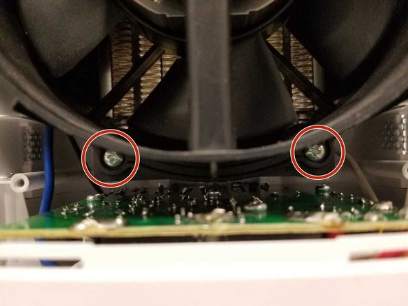

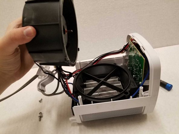

  4. Lasko CD08200 Fan Replacement: crwdns2935265:04crwdnd2935265:01crwdnd2935265:03crwdne2935265:0 Lasko CD08200 Fan Replacement: crwdns2935265:04crwdnd2935265:02crwdnd2935265:03crwdne2935265:0 Lasko CD08200 Fan Replacement: crwdns2935265:04crwdnd2935265:03crwdnd2935265:03crwdne2935265:0
    • Remove the four 14mm screws housing the fan using the Phillips #2 screwdriver.
    • Remove the top of the fan housing with the fan attached and place it on the table.

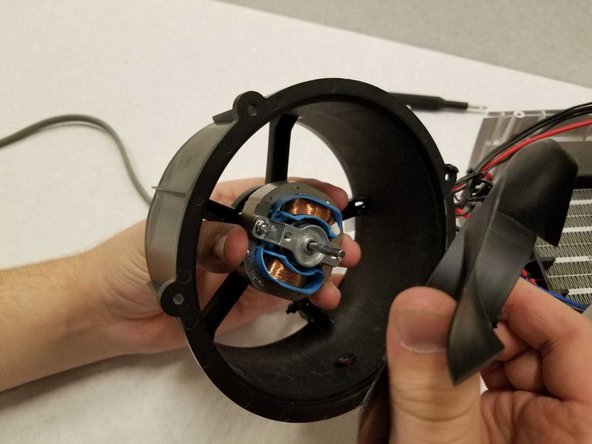

  5. Lasko CD08200 Fan Replacement, Fan: crwdns2935265:05crwdnd2935265:01crwdnd2935265:02crwdne2935265:0 Lasko CD08200 Fan Replacement, Fan: crwdns2935265:05crwdnd2935265:02crwdnd2935265:02crwdne2935265:0
    • While holding onto the back of the fan housing with one hand and holding the center of the propeller, pull the propeller out.
    • During reassembly, push the propeller and red plate together into the metal shaft until you feel the plate click.
