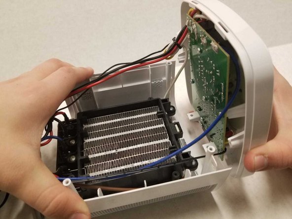

  4. Lasko CD08200 Control Panel Replacement: crwdns2935265:04crwdnd2935265:01crwdnd2935265:03crwdne2935265:0 Lasko CD08200 Control Panel Replacement: crwdns2935265:04crwdnd2935265:02crwdnd2935265:03crwdne2935265:0 Lasko CD08200 Control Panel Replacement: crwdns2935265:04crwdnd2935265:03crwdnd2935265:03crwdne2935265:0
    • Remove the four 14mm screws housing the fan using the Phillips #2 screwdriver.
    • Remove the top of the fan housing with the fan attached and place it on the table.

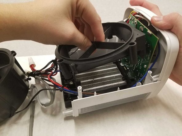

  5. Lasko CD08200 Control Panel Replacement, Control Panel: crwdns2935265:05crwdnd2935265:01crwdnd2935265:02crwdne2935265:0 Lasko CD08200 Control Panel Replacement, Control Panel: crwdns2935265:05crwdnd2935265:02crwdnd2935265:02crwdne2935265:0
    • Unscrew the four rings using the Phillips #2.
    • Gently remove the fan base from the device.

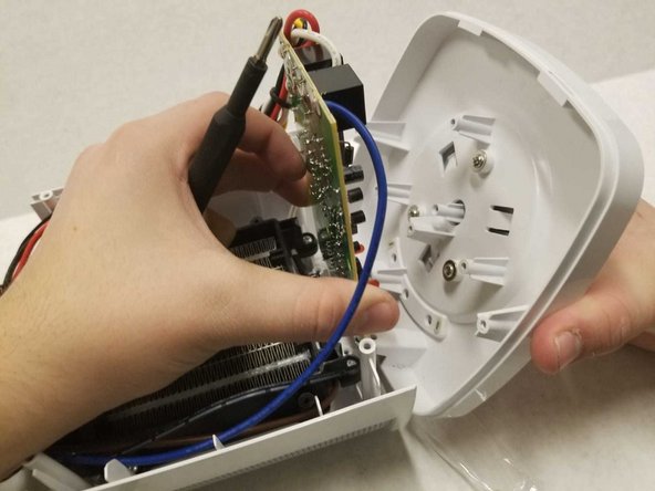

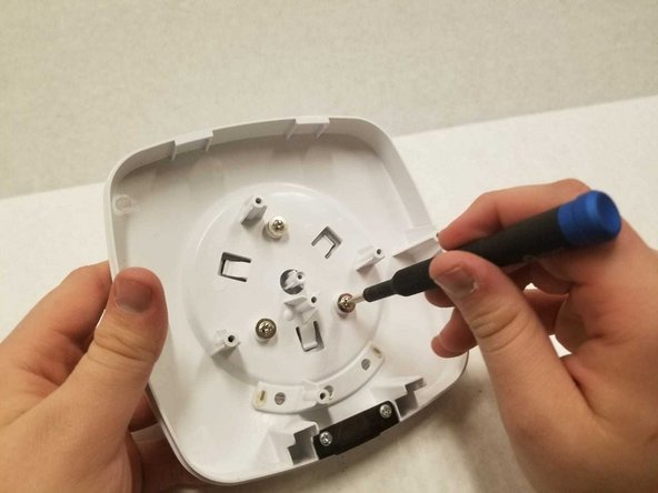

  6. Lasko CD08200 Control Panel Replacement: crwdns2935265:06crwdnd2935265:01crwdnd2935265:03crwdne2935265:0 Lasko CD08200 Control Panel Replacement: crwdns2935265:06crwdnd2935265:02crwdnd2935265:03crwdne2935265:0 Lasko CD08200 Control Panel Replacement: crwdns2935265:06crwdnd2935265:03crwdnd2935265:03crwdne2935265:0
    • Remove the four 14mm screws using the Phillips #2 screwdriver.
    • Gently detach the control panel from the device.

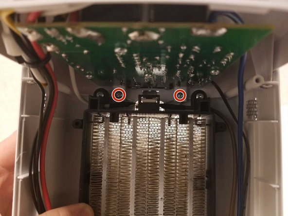

  7. Lasko CD08200 Control Panel Replacement: crwdns2935265:07crwdnd2935265:01crwdnd2935265:02crwdne2935265:0 Lasko CD08200 Control Panel Replacement: crwdns2935265:07crwdnd2935265:02crwdnd2935265:02crwdne2935265:0
    • Remove the five 14mm screws using the Phillips #2 screwdriver.
    • Pull apart the motherboard from the panel.

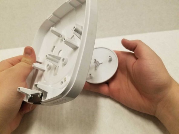

  8. Lasko CD08200 Control Panel Replacement: crwdns2935265:08crwdnd2935265:01crwdnd2935265:03crwdne2935265:0 Lasko CD08200 Control Panel Replacement: crwdns2935265:08crwdnd2935265:02crwdnd2935265:03crwdne2935265:0 Lasko CD08200 Control Panel Replacement: crwdns2935265:08crwdnd2935265:03crwdnd2935265:03crwdne2935265:0
    • Remove the three 10mm screws using the Phillips #2 screwdriver.
    • Pull the button from the panel’s top.
    • During reassembly of the top panel, you must align the LED light with the three windows of the top panel and back panel.
