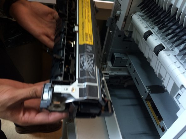

  6. LaserJet P4014DN Printer Swing Plate Fuser Drive (Swing Plate Assembly) Replacement: crwdns2935265:06crwdnd2935265:01crwdnd2935265:02crwdne2935265:0 LaserJet P4014DN Printer Swing Plate Fuser Drive (Swing Plate Assembly) Replacement: crwdns2935265:06crwdnd2935265:02crwdnd2935265:02crwdne2935265:0
    • Remove the fuser unit.
    • Pinch blue tab on each side of fuser. Pull away fuser.

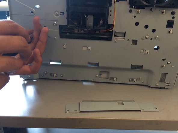

    • Remove the back lower cover.

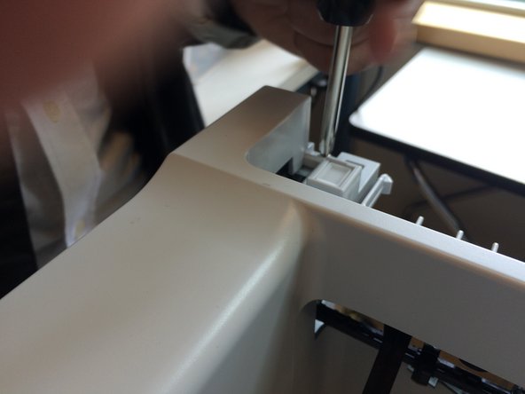

    • Remove the four screws from the top cover.

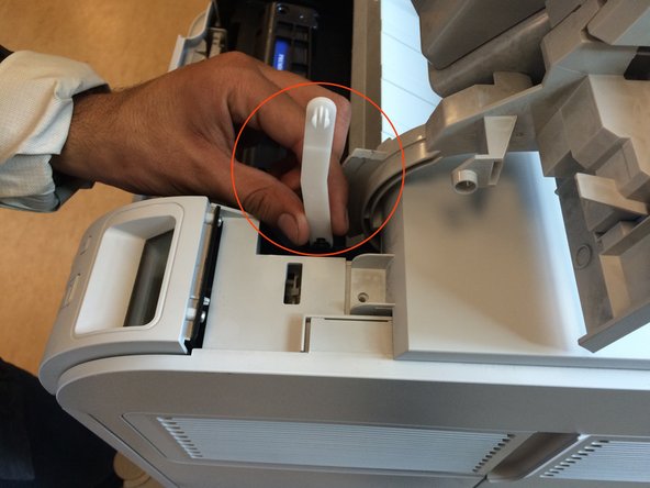

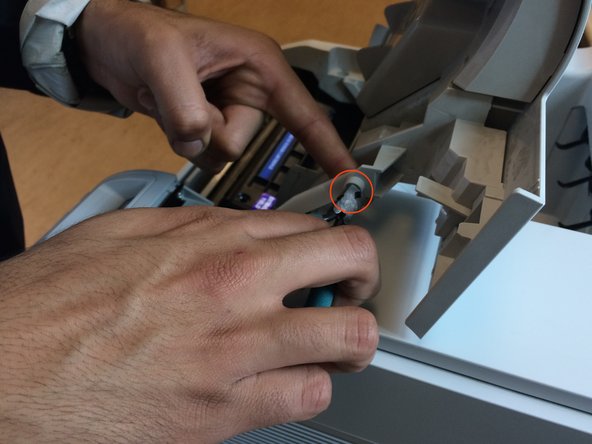

  9. LaserJet P4014DN Printer Swing Plate Fuser Drive (Swing Plate Assembly) Replacement: crwdns2935265:09crwdnd2935265:01crwdnd2935265:03crwdne2935265:0 LaserJet P4014DN Printer Swing Plate Fuser Drive (Swing Plate Assembly) Replacement: crwdns2935265:09crwdnd2935265:02crwdnd2935265:03crwdne2935265:0 LaserJet P4014DN Printer Swing Plate Fuser Drive (Swing Plate Assembly) Replacement: crwdns2935265:09crwdnd2935265:03crwdnd2935265:03crwdne2935265:0

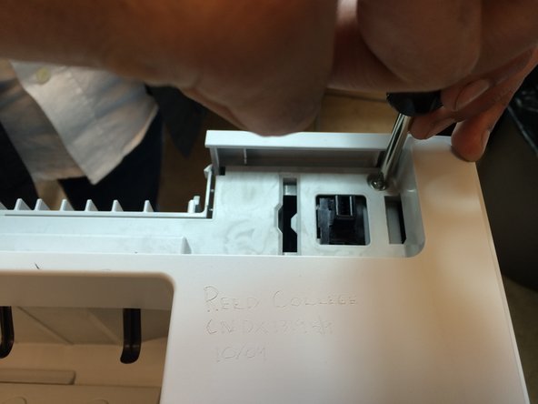

    • Open the top cover and unlatch the catch.
    • The catch is circled in red. Be careful with it, as it is fragile. Push it in with a screwdriver to ease it loose from its place. Do not remove top cover until the catch is released.

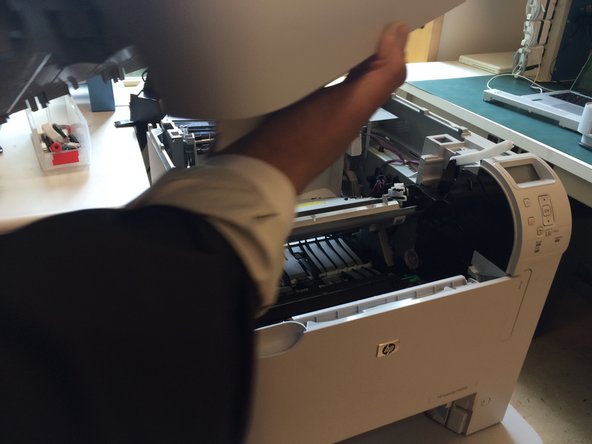

  12. LaserJet P4014DN Printer Swing Plate Fuser Drive (Swing Plate Assembly) Replacement: crwdns2935265:012crwdnd2935265:01crwdnd2935265:03crwdne2935265:0 LaserJet P4014DN Printer Swing Plate Fuser Drive (Swing Plate Assembly) Replacement: crwdns2935265:012crwdnd2935265:02crwdnd2935265:03crwdne2935265:0 LaserJet P4014DN Printer Swing Plate Fuser Drive (Swing Plate Assembly) Replacement: crwdns2935265:012crwdnd2935265:03crwdnd2935265:03crwdne2935265:0

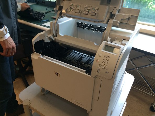

    • Remove the top cover.
    • Should straight up with ease. If not, go back and check your work. Ensure that all four screws have been removed and that the catch has been released on the door hinge.

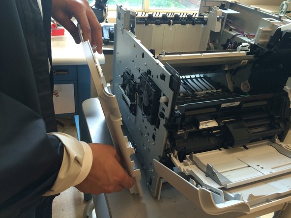

  13. LaserJet P4014DN Printer Swing Plate Fuser Drive (Swing Plate Assembly) Replacement: crwdns2935265:013crwdnd2935265:01crwdnd2935265:03crwdne2935265:0 LaserJet P4014DN Printer Swing Plate Fuser Drive (Swing Plate Assembly) Replacement: crwdns2935265:013crwdnd2935265:02crwdnd2935265:03crwdne2935265:0 LaserJet P4014DN Printer Swing Plate Fuser Drive (Swing Plate Assembly) Replacement: crwdns2935265:013crwdnd2935265:03crwdnd2935265:03crwdne2935265:0
    • Remove the left side panel.
    • Start by loosening back side from clips, working your way to the front. Be careful when removing the panel clip near the front printer door (slide panel carefully past door).

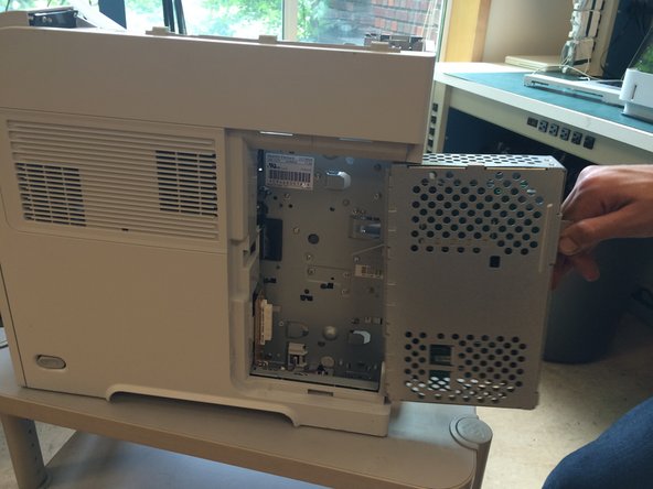

  14. LaserJet P4014DN Printer Swing Plate Fuser Drive (Swing Plate Assembly) Replacement: crwdns2935265:014crwdnd2935265:01crwdnd2935265:03crwdne2935265:0 LaserJet P4014DN Printer Swing Plate Fuser Drive (Swing Plate Assembly) Replacement: crwdns2935265:014crwdnd2935265:02crwdnd2935265:03crwdne2935265:0 LaserJet P4014DN Printer Swing Plate Fuser Drive (Swing Plate Assembly) Replacement: crwdns2935265:014crwdnd2935265:03crwdnd2935265:03crwdne2935265:0
    • Remove the two screws from the formatter and slide it free.

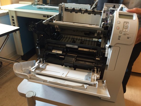

  15. LaserJet P4014DN Printer Swing Plate Fuser Drive (Swing Plate Assembly) Replacement: crwdns2935265:015crwdnd2935265:01crwdnd2935265:01crwdne2935265:0

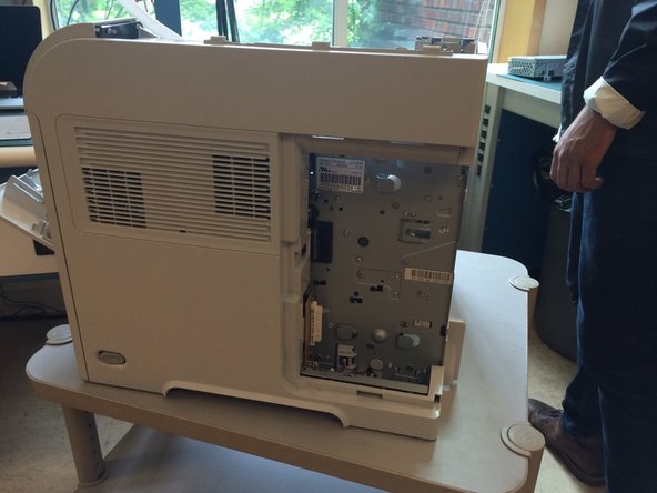

    • Remove the small back left side plate cover.
  16. LaserJet P4014DN Printer Swing Plate Fuser Drive (Swing Plate Assembly) Replacement: crwdns2935265:016crwdnd2935265:01crwdnd2935265:02crwdne2935265:0 LaserJet P4014DN Printer Swing Plate Fuser Drive (Swing Plate Assembly) Replacement: crwdns2935265:016crwdnd2935265:02crwdnd2935265:02crwdne2935265:0
    • Remove the right side cover.
    • When removing the right side cover, notice plastic clip that attached to the power button assembly. Remember that this clip has to be reattached when you put the printer back together.

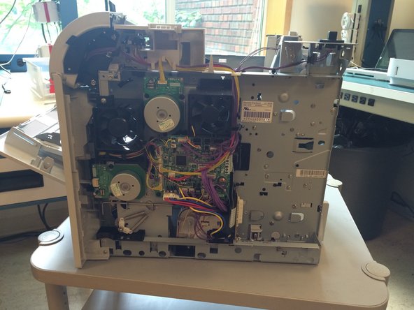

  17. LaserJet P4014DN Printer Swing Plate Fuser Drive (Swing Plate Assembly) Replacement: crwdns2935265:017crwdnd2935265:01crwdnd2935265:01crwdne2935265:0
    • Take stock and organize your removed printer pieces.
    • This is not an organized stack. Lol. Maybe take a break. This repair can be exhausting.

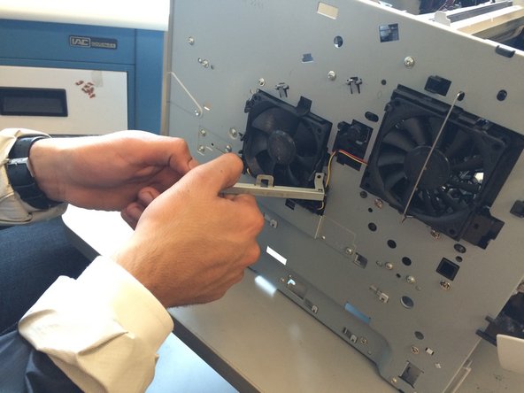

  18. LaserJet P4014DN Printer Swing Plate Fuser Drive (Swing Plate Assembly) Replacement: crwdns2935265:018crwdnd2935265:01crwdnd2935265:03crwdne2935265:0 LaserJet P4014DN Printer Swing Plate Fuser Drive (Swing Plate Assembly) Replacement: crwdns2935265:018crwdnd2935265:02crwdnd2935265:03crwdne2935265:0 LaserJet P4014DN Printer Swing Plate Fuser Drive (Swing Plate Assembly) Replacement: crwdns2935265:018crwdnd2935265:03crwdnd2935265:03crwdne2935265:0

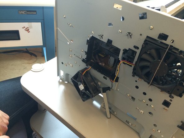

    • Remove the two screws from left fan cover on right side of printer, pull fan free, disconnect fan cable.
    • Screws are circled in red.

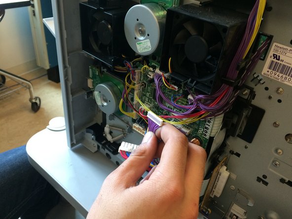

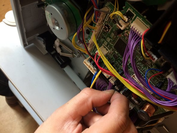

  19. LaserJet P4014DN Printer Swing Plate Fuser Drive (Swing Plate Assembly) Replacement: crwdns2935265:019crwdnd2935265:01crwdnd2935265:03crwdne2935265:0 LaserJet P4014DN Printer Swing Plate Fuser Drive (Swing Plate Assembly) Replacement: crwdns2935265:019crwdnd2935265:02crwdnd2935265:03crwdne2935265:0 LaserJet P4014DN Printer Swing Plate Fuser Drive (Swing Plate Assembly) Replacement: crwdns2935265:019crwdnd2935265:03crwdnd2935265:03crwdne2935265:0

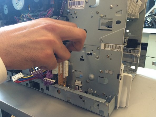

    • Disconnect the five power cables.
    • Cables are circled in red.
    • Proceed with caution; some of the cables need to have tabs pushed in before they will disconnect. Removing the cables will require some force, but avoid pulling out other tangled cables when removing the necessary ones.

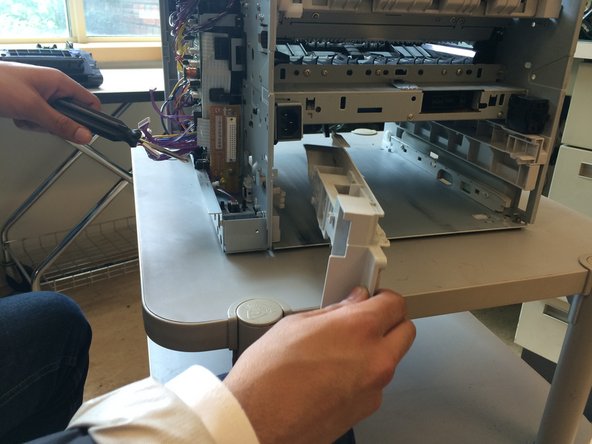

  21. LaserJet P4014DN Printer Swing Plate Fuser Drive (Swing Plate Assembly) Replacement: crwdns2935265:021crwdnd2935265:01crwdnd2935265:02crwdne2935265:0 LaserJet P4014DN Printer Swing Plate Fuser Drive (Swing Plate Assembly) Replacement: crwdns2935265:021crwdnd2935265:02crwdnd2935265:02crwdne2935265:0
    • Remove the grey power assembly slide.
    • Use a screwdriver to press circular grey tab. After the tab is released, pull out the grey power assembly.
  22. LaserJet P4014DN Printer Swing Plate Fuser Drive (Swing Plate Assembly) Replacement: crwdns2935265:022crwdnd2935265:01crwdnd2935265:02crwdne2935265:0 LaserJet P4014DN Printer Swing Plate Fuser Drive (Swing Plate Assembly) Replacement: crwdns2935265:022crwdnd2935265:02crwdnd2935265:02crwdne2935265:0
    • Guide all five disconnected cables through the black plastic cable guide.
    • Be very careful! The cable guide is small and the wires are fragile.
    • Try one cable at a time.
    • All five cables should end up on the inside of the printer.

    • On the other side of the printer, remove six screws and the second fan plate. Disconnect the fan cable.
    • Fan cable (red and yellow) is attached underneath black plastic fan frame.

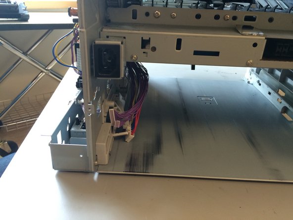

  24. LaserJet P4014DN Printer Swing Plate Fuser Drive (Swing Plate Assembly) Replacement: crwdns2935265:024crwdnd2935265:01crwdnd2935265:02crwdne2935265:0 LaserJet P4014DN Printer Swing Plate Fuser Drive (Swing Plate Assembly) Replacement: crwdns2935265:024crwdnd2935265:02crwdnd2935265:02crwdne2935265:0
    • Remove the power supply.
    • You should now be able to freely slide the power supply out horizontally. Make sure the power cables are tucked safely beneath the power tray.

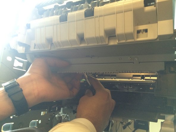

  25. LaserJet P4014DN Printer Swing Plate Fuser Drive (Swing Plate Assembly) Replacement: crwdns2935265:025crwdnd2935265:01crwdnd2935265:02crwdne2935265:0 LaserJet P4014DN Printer Swing Plate Fuser Drive (Swing Plate Assembly) Replacement: crwdns2935265:025crwdnd2935265:02crwdnd2935265:02crwdne2935265:0
    • Remove the four screws from underside
    • Two of the screws are much easier to access than the others. You'll need to reach beneath to feel for the final two. Try to angle the end of your screwdriver away from you.
    • Only the visible screws are circled in red.

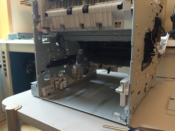

  26. LaserJet P4014DN Printer Swing Plate Fuser Drive (Swing Plate Assembly) Replacement: crwdns2935265:026crwdnd2935265:01crwdnd2935265:01crwdne2935265:0
    • Congratulations! You've made it to the swing plate!

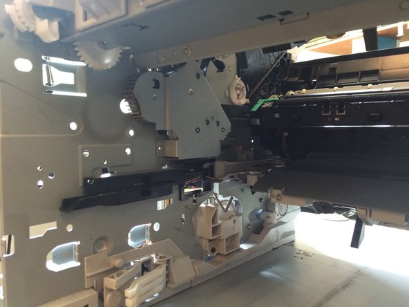

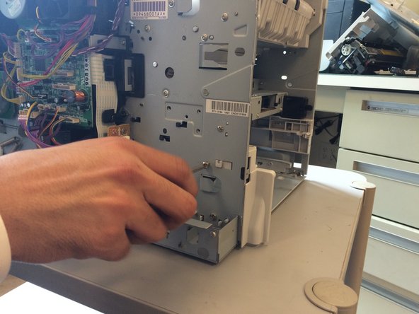

  27. LaserJet P4014DN Printer Swing Plate Fuser Drive (Swing Plate Assembly) Replacement: crwdns2935265:027crwdnd2935265:01crwdnd2935265:03crwdne2935265:0 LaserJet P4014DN Printer Swing Plate Fuser Drive (Swing Plate Assembly) Replacement: crwdns2935265:027crwdnd2935265:02crwdnd2935265:03crwdne2935265:0 LaserJet P4014DN Printer Swing Plate Fuser Drive (Swing Plate Assembly) Replacement: crwdns2935265:027crwdnd2935265:03crwdnd2935265:03crwdne2935265:0

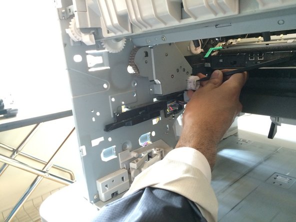

    • Remove the four screws holding the swing plate assembly in place.
    • Note that one screw is behind the white gear, which needs to be carefully removed by pushing down on the tab holding it in and easing it free.
