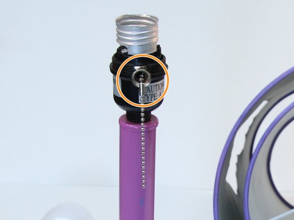

      • Unplug the broken lamp and ensure you have all of the parts necessary for the repair.
    2. Lamp Pull Chain Replacement: crwdns2935265:02crwdnd2935265:01crwdnd2935265:02crwdne2935265:0 Lamp Pull Chain Replacement: crwdns2935265:02crwdnd2935265:02crwdnd2935265:02crwdne2935265:0
      • Remove the light bulb from the lamp.
    3. Lamp Pull Chain Replacement: crwdns2935265:03crwdnd2935265:01crwdnd2935265:02crwdne2935265:0 Lamp Pull Chain Replacement: crwdns2935265:03crwdnd2935265:02crwdnd2935265:02crwdne2935265:0

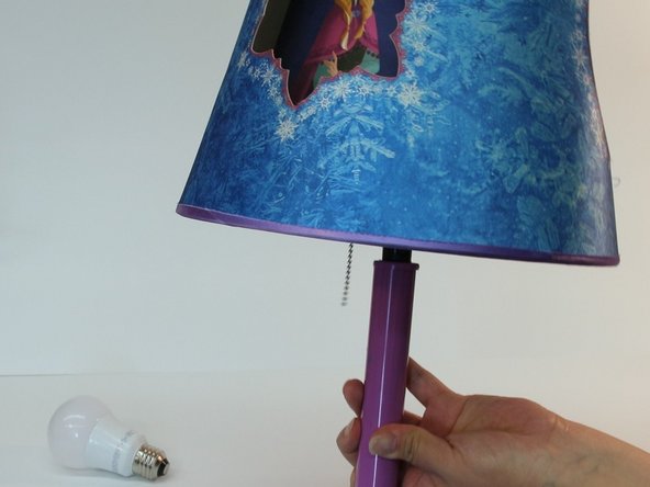

      • Unscrew the lamp shade from the base by turning it counter-clockwise.
    4. Lamp Pull Chain Replacement: crwdns2935265:04crwdnd2935265:01crwdnd2935265:01crwdne2935265:0

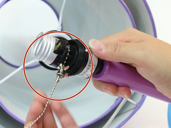

      • Gently pull the socket from the base to expose the broken chain section.
    5. Lamp Pull Chain Replacement: crwdns2935265:05crwdnd2935265:01crwdnd2935265:02crwdne2935265:0 Lamp Pull Chain Replacement: crwdns2935265:05crwdnd2935265:02crwdnd2935265:02crwdne2935265:0

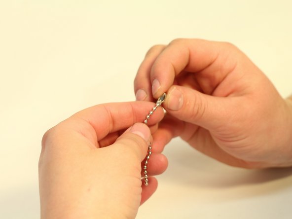

      • Attach the chain connector to the extra chain.
    6. Lamp Pull Chain Replacement: crwdns2935265:06crwdnd2935265:01crwdnd2935265:02crwdne2935265:0 Lamp Pull Chain Replacement: crwdns2935265:06crwdnd2935265:02crwdnd2935265:02crwdne2935265:0
      • Connect the chain with the chain connector to the broken chain on the lamp base.
    7. Lamp Pull Chain Replacement: crwdns2935265:07crwdnd2935265:01crwdnd2935265:03crwdne2935265:0 Lamp Pull Chain Replacement: crwdns2935265:07crwdnd2935265:02crwdnd2935265:03crwdne2935265:0 Lamp Pull Chain Replacement: crwdns2935265:07crwdnd2935265:03crwdnd2935265:03crwdne2935265:0
      • Tilting the lamp in one hand, use your other hand to guide the chain into the hole that leads from inside of the socket to outside of the lamp.
      • The chain will go down through this hole.
    8. Lamp Pull Chain Replacement: crwdns2935265:08crwdnd2935265:01crwdnd2935265:01crwdne2935265:0
      • Gently push the socket back into place.
    9. Lamp Pull Chain Replacement: crwdns2935265:09crwdnd2935265:01crwdnd2935265:02crwdne2935265:0 Lamp Pull Chain Replacement: crwdns2935265:09crwdnd2935265:02crwdnd2935265:02crwdne2935265:0
      • Screw the lamp shade back onto the base of the lamp by turning it clockwise.
    10. Lamp Pull Chain Replacement: crwdns2935265:010crwdnd2935265:01crwdnd2935265:01crwdne2935265:0
      • Replace the light bulb into the lamp socket.

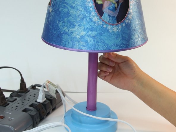

    11. Lamp Pull Chain Replacement: crwdns2935265:011crwdnd2935265:01crwdnd2935265:02crwdne2935265:0 Lamp Pull Chain Replacement: crwdns2935265:011crwdnd2935265:02crwdnd2935265:02crwdne2935265:0
      • Plug your lamp into an outlet and turn it on!
      • You will pull down on the chain to do this.
