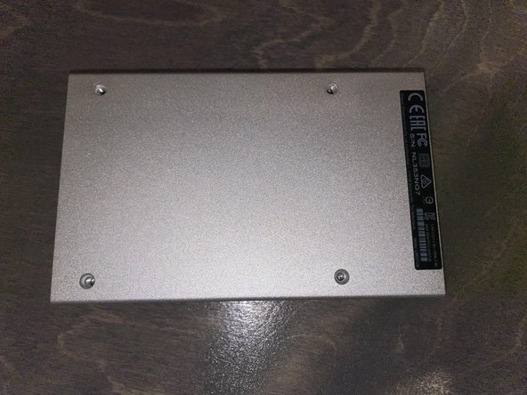

    • Remove these 4x Torx T8 screws

Thanks for confirming the T8 Torx security bit - I had to buy a set!
