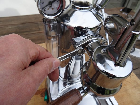

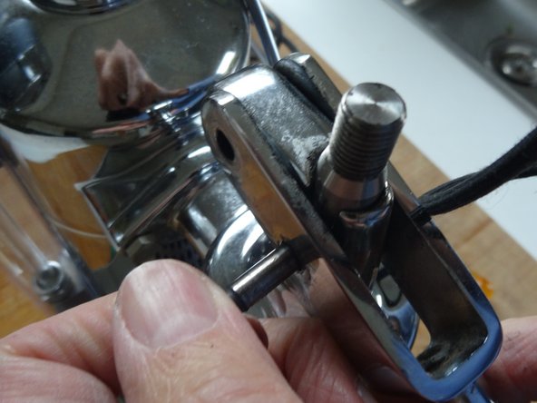

  2. La Pavoni: Replace gaskets in lever coffee machines, Unscrew the cap nuts: crwdns2935265:02crwdnd2935265:01crwdnd2935265:02crwdne2935265:0 La Pavoni: Replace gaskets in lever coffee machines, Unscrew the cap nuts: crwdns2935265:02crwdnd2935265:02crwdnd2935265:02crwdne2935265:0

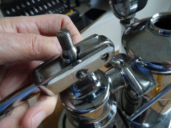

    • The two M14 cap nuts at the top of the piston rod are locked against each other. Hold the lower nut in place with an open-end wrench and unscrew the upper nut.
    • When reassembling, make sure that the lower nut still has some downward play. For this, you can insert a small flat-head screwdriver under the nut before locking the upper nut against the lower one.
    • Remove both nuts and keep them in a safe place.
  3. La Pavoni: Replace gaskets in lever coffee machines, Removing the lever arm: crwdns2935265:03crwdnd2935265:01crwdnd2935265:03crwdne2935265:0 La Pavoni: Replace gaskets in lever coffee machines, Removing the lever arm: crwdns2935265:03crwdnd2935265:02crwdnd2935265:03crwdne2935265:0 La Pavoni: Replace gaskets in lever coffee machines, Removing the lever arm: crwdns2935265:03crwdnd2935265:03crwdnd2935265:03crwdne2935265:0

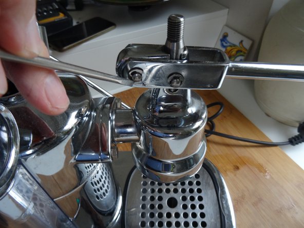

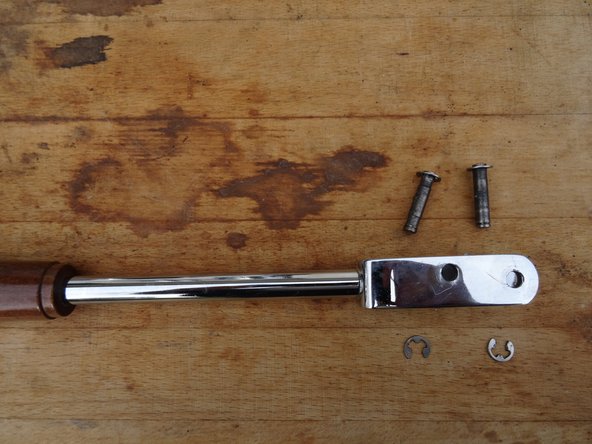

    • The lever arm is mounted with two pins, which are secured on both sides with a ring pin. It's sufficient to loosen one side.
    • When reassembling, make sure that the rear hole is higher.
    • Push the two ring pins out of their grooves on one side, using a suitable tool. Be careful not to scratch the chrome finish, so it's best to use a plastic tool. Remove the rings.
    • Push the pins out. The lever is now ready to be removed.
    • The rear pin slides into a metal tube. Push it out and keep it in a safe place.

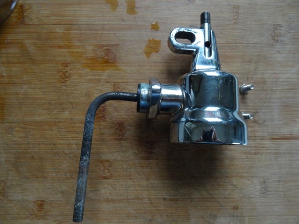

  5. La Pavoni: Replace gaskets in lever coffee machines: crwdns2935265:05crwdnd2935265:01crwdnd2935265:03crwdne2935265:0 La Pavoni: Replace gaskets in lever coffee machines: crwdns2935265:05crwdnd2935265:02crwdnd2935265:03crwdne2935265:0 La Pavoni: Replace gaskets in lever coffee machines: crwdns2935265:05crwdnd2935265:03crwdnd2935265:03crwdne2935265:0

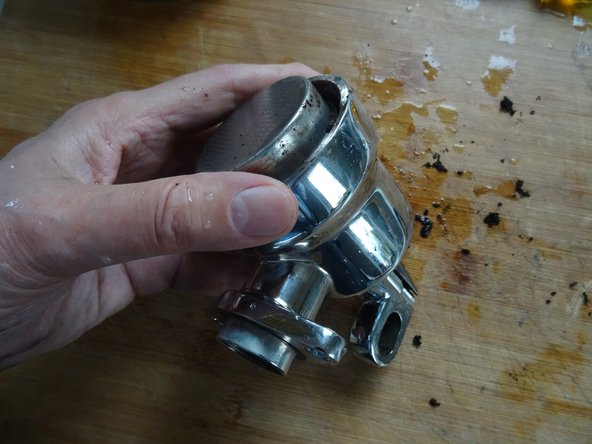

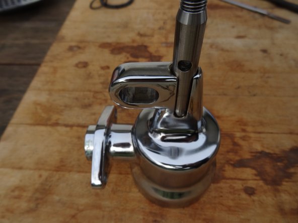

    • The unit is attached to the boiler with two M10 hexagon screws. Unscrew the two screws.
    • Remove the unit.
    • Pay attention to the riser pipe. You can carefully unscrew it. Replace the black sealing plug during reassembly if necessary.

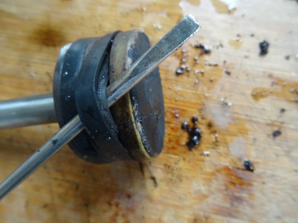

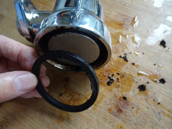

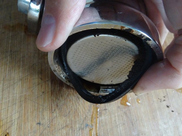

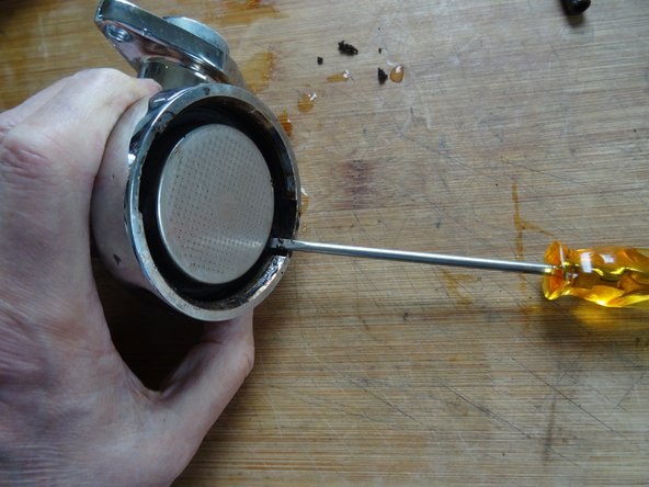

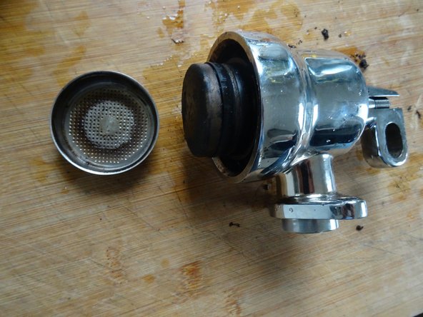

    • Now remove the large gasket on the sieve, using a suitable tool. Work extra carefully, so you don't damage the metal surfaces.
    • When reassembling, pay attention to how the gasket is positioned; it is not symmetrical, the flat side is on the outside.
    • You can also push the ring out together with the sieve using the piston, but this is quite difficult.
  7. La Pavoni: Replace gaskets in lever coffee machines: crwdns2935265:07crwdnd2935265:01crwdnd2935265:02crwdne2935265:0 La Pavoni: Replace gaskets in lever coffee machines: crwdns2935265:07crwdnd2935265:02crwdnd2935265:02crwdne2935265:0

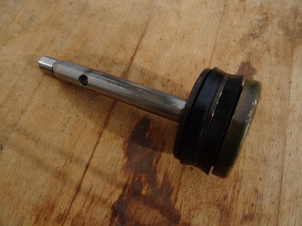

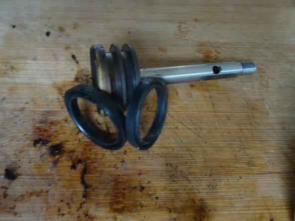

    • Push out the sieve and the piston.
  8. La Pavoni: Replace gaskets in lever coffee machines: crwdns2935265:08crwdnd2935265:01crwdnd2935265:03crwdne2935265:0 La Pavoni: Replace gaskets in lever coffee machines: crwdns2935265:08crwdnd2935265:02crwdnd2935265:03crwdne2935265:0 La Pavoni: Replace gaskets in lever coffee machines: crwdns2935265:08crwdnd2935265:03crwdnd2935265:03crwdne2935265:0

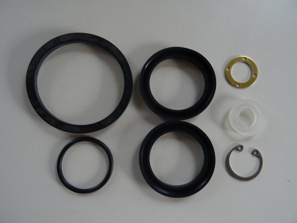

    • Remove both lip gasket rings on the piston.
    • Be mindful of the direction when assembling: The lip always points to the pressure side, so for the upper gasket it points up, and for the lower one it points down.
    • Picture 3 shows the clean piston with two new gaskets.

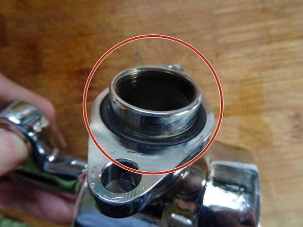

  9. La Pavoni: Replace gaskets in lever coffee machines: crwdns2935265:09crwdnd2935265:01crwdnd2935265:01crwdne2935265:0
    • Remove the gasket between the unit and the boiler.

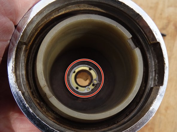

  10. La Pavoni: Replace gaskets in lever coffee machines: crwdns2935265:010crwdnd2935265:01crwdnd2935265:03crwdne2935265:0 La Pavoni: Replace gaskets in lever coffee machines: crwdns2935265:010crwdnd2935265:02crwdnd2935265:03crwdne2935265:0 La Pavoni: Replace gaskets in lever coffee machines: crwdns2935265:010crwdnd2935265:03crwdnd2935265:03crwdne2935265:0

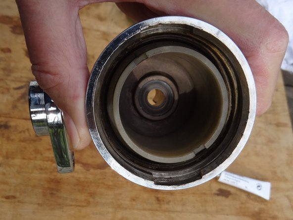

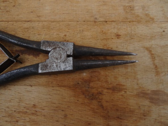

    • The piston rod inside the cylinder is sealed with a silicone lip gasket. To replace it, you must first loosen the circlip. This is a bit tricky, so special circlip pliers are a big help.
    • Make sure the metal surfaces are not damaged.
    • Press both holes on the circlip together. You can then remove the ring from its groove.
    • There is a perforated brass disc under the circlip, and a silicone gasket under that. Remove the brass disc. Use a plastic tool to push the silicone gasket out from the other side.
    • Here too, the lips face the pressure side, i.e. into the cylinder.

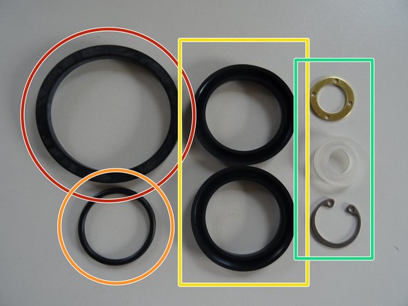

  11. La Pavoni: Replace gaskets in lever coffee machines: crwdns2935265:011crwdnd2935265:01crwdnd2935265:02crwdne2935265:0 La Pavoni: Replace gaskets in lever coffee machines: crwdns2935265:011crwdnd2935265:02crwdnd2935265:02crwdne2935265:0
    • Here are the new rings:
    • Gasket on the sieve
    • Gasket between the unit and boiler
    • Two piston rings
    • Brass disc, silicone gasket and circlip on the piston rod
    • Clean each part thoroughly. If you notice limescale in the boiler, now is a good time to remove it.
    • Lightly grease the new sealing rings and sliding parts with food-safe silicone and reassemble everything.
