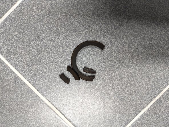

  3. La Pavoni Domus Bar pre 2007 - Group seal replacement Replacement, Remove the silicone seal: crwdns2935265:03crwdnd2935265:01crwdnd2935265:02crwdne2935265:0 La Pavoni Domus Bar pre 2007 - Group seal replacement Replacement, Remove the silicone seal: crwdns2935265:03crwdnd2935265:02crwdnd2935265:02crwdne2935265:0
    • Remove the seal by prying it out of the group set.
    • Make use of the cutouts in the group casing.
    • Older seals can dry out and might break. That’s no problem as you need to replace the seal anyway.
    • When adding the new seal, use the guide backwards. Make sure the seal fits well. Don’t tighten the copper screw too hard and clean or service the machine regularly.
