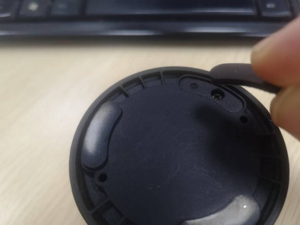

  2. LOOKAH Unicorn Erig Battery Replacement Replacement, Remove Non Slip Pads: crwdns2935265:02crwdnd2935265:01crwdnd2935265:01crwdne2935265:0
    • Remove the three nonslip pads from the base of the unit.
    • This will expose three small crosshead (phillips) screws
  3. LOOKAH Unicorn Erig Battery Replacement Replacement: crwdns2935265:03crwdnd2935265:01crwdnd2935265:01crwdne2935265:0

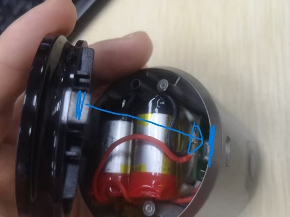

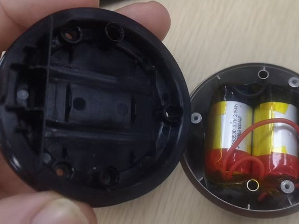

    • Use a small screwdriver to remove the screws
    • Lift off the plastic base to show the battery and components

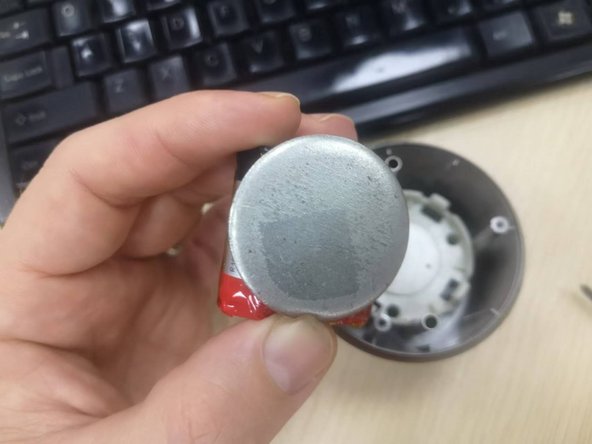

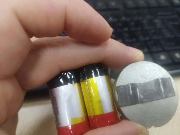

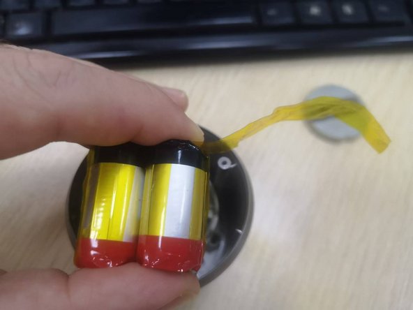

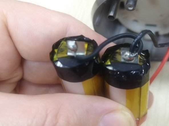

  4. LOOKAH Unicorn Erig Battery Replacement Replacement, Remove the battery: crwdns2935265:04crwdnd2935265:01crwdnd2935265:03crwdne2935265:0 LOOKAH Unicorn Erig Battery Replacement Replacement, Remove the battery: crwdns2935265:04crwdnd2935265:02crwdnd2935265:03crwdne2935265:0 LOOKAH Unicorn Erig Battery Replacement Replacement, Remove the battery: crwdns2935265:04crwdnd2935265:03crwdnd2935265:03crwdne2935265:0
    • Carefully lift out the batteries.
    • Remove the metal plate the batteries are stuck to
    • Remove the tape holding the batteries together

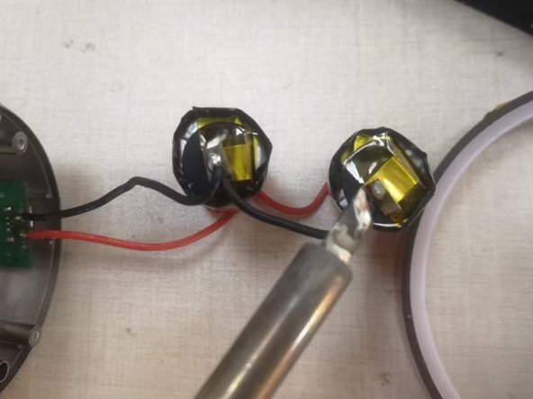

  5. LOOKAH Unicorn Erig Battery Replacement Replacement, Unsolder batteries: crwdns2935265:05crwdnd2935265:01crwdnd2935265:03crwdne2935265:0 LOOKAH Unicorn Erig Battery Replacement Replacement, Unsolder batteries: crwdns2935265:05crwdnd2935265:02crwdnd2935265:03crwdne2935265:0 LOOKAH Unicorn Erig Battery Replacement Replacement, Unsolder batteries: crwdns2935265:05crwdnd2935265:03crwdnd2935265:03crwdne2935265:0
    • Use a Solder Iron on to heat the solder and remove the cable from the batteries
  6. LOOKAH Unicorn Erig Battery Replacement Replacement, Solder new batteries in place: crwdns2935265:06crwdnd2935265:01crwdnd2935265:02crwdne2935265:0 LOOKAH Unicorn Erig Battery Replacement Replacement, Solder new batteries in place: crwdns2935265:06crwdnd2935265:02crwdnd2935265:02crwdne2935265:0
    • Use a soldering iron to connect new battery.
    • Tape the two new batteries back together
    • Click the power button five times to see if the device turns on
  7. LOOKAH Unicorn Erig Battery Replacement Replacement: crwdns2935265:08crwdnd2935265:01crwdnd2935265:03crwdne2935265:0 LOOKAH Unicorn Erig Battery Replacement Replacement: crwdns2935265:08crwdnd2935265:02crwdnd2935265:03crwdne2935265:0 LOOKAH Unicorn Erig Battery Replacement Replacement: crwdns2935265:08crwdnd2935265:03crwdnd2935265:03crwdne2935265:0
    • Replace the double-sided tape on the metal plate and connect it to batteries.
    • Reseat batteries and metal disc, with the metal disc side down into the unit's base. Note the orientation of the batteries. The base cover will not fit on if they are not the correct way around.
    • Line up the base cover and put it in place, with the plastic tab towards the USB port and the screws holes lined up
