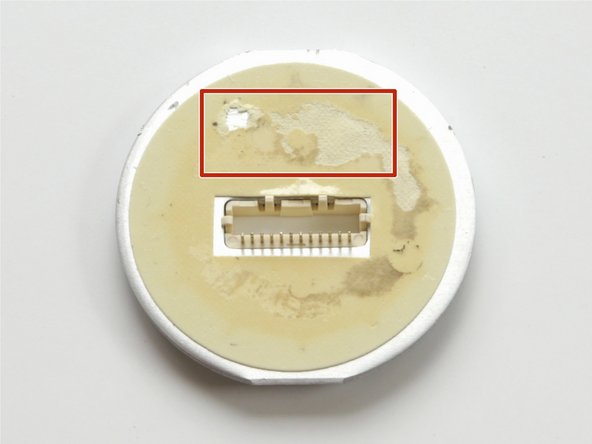

  3. LIFX Color 1000 Teardown, Examine Thermal Pad: crwdns2935265:03crwdnd2935265:01crwdnd2935265:03crwdne2935265:0 LIFX Color 1000 Teardown, Examine Thermal Pad: crwdns2935265:03crwdnd2935265:02crwdnd2935265:03crwdne2935265:0 LIFX Color 1000 Teardown, Examine Thermal Pad: crwdns2935265:03crwdnd2935265:03crwdnd2935265:03crwdne2935265:0
    • If you compare the under-side of the PCB with the bulb's case, you'll see if the thermal pad was adhered properly.
    • In these photos you can see the pad was only partially attached on one side. The other side of the PCB was lifted several millimeters away from the bulb's base.

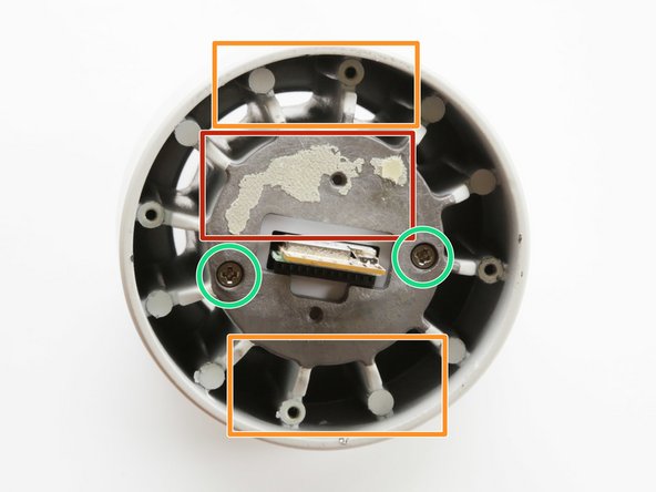

    • The bulb's metal base serves as a heatsink. You can see the air channels running vertically along the sides. This is why these bulbs should only be installed in a vertical orientation to maintain proper airflow.
    • If you plan to re-assemble the bulb, you should scrape off all the old thermal pad from the PCB and case. Both surfaces should be clean. Replace it with a good thermal adhesive epoxy, following the manufacturer's directions.
    • Note the two Phillips-head screws in the central portion of the metal case (marked in green circles). We remove these in the next steps.

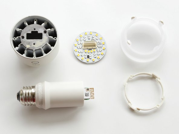

  4. LIFX Color 1000 Teardown, The Guts: crwdns2935265:04crwdnd2935265:01crwdnd2935265:02crwdne2935265:0 LIFX Color 1000 Teardown, The Guts: crwdns2935265:04crwdnd2935265:02crwdnd2935265:02crwdne2935265:0
    • Notice the back of the WiFi PCB. There is the female pin-header connector for the LED board, and a series of gold pads for a manufacturing test jig.
    • If you are feeling adventurous, you may be able to find JTAG, serial ports, or other fun hacking opportunities among those pads.
    • If you remove the two screws, the electrical base unit slides out of the metal heatsink case. The electronics are potted and not easily accessible.
    • Re-assembly is the reverse of disassembly.

On the last pic, on the wifi board is that a button or a U.fl connector?
Gigabit87898 - crwdns2934203:0crwdne2934203:0
Not a U.fl connector, but very similar, with a socket instead of a pin. It's a switched RF test point used during manufacture, like this: http://www.mouser.com/new/murata/muratas... - Basically, you plug in and it disconnects whatever is downstream; in this case, the PCB antenna. So you could certainly use it for your own antenna, but I'm not sure if anyone makes cable connectors per se; it may only be test probes for use in a manufacturing test jig. Can always rip it off and slap on a u.fl instead =)
