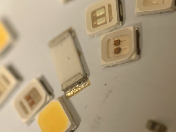

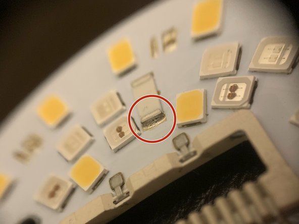

  4. LIFX BR30 Resolder Resistors, Inspect PCB Components: crwdns2935265:04crwdnd2935265:01crwdnd2935265:01crwdne2935265:0
    • On my BR30, there are two resistors that seem to fail, see red-circled resistors in photo.
    • Use a 10x loupe to look closely at the red-circled resistors, the ends nearest to the center of the PCB may have cracks as shown in Step 2 and Step 3 closeup photos.

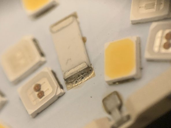

  5. LIFX BR30 Resolder Resistors, Observe Top Resistor: crwdns2935265:05crwdnd2935265:01crwdnd2935265:03crwdne2935265:0 LIFX BR30 Resolder Resistors, Observe Top Resistor: crwdns2935265:05crwdnd2935265:02crwdnd2935265:03crwdne2935265:0 LIFX BR30 Resolder Resistors, Observe Top Resistor: crwdns2935265:05crwdnd2935265:03crwdnd2935265:03crwdne2935265:0
    • Use a 10x loupe and look at the top resistor and its side nearest to the PCB's center.
    • As shown in the 10x loupe photos on the left, the top resistor on my BR30 had a crack running along the solder joint.
  6. LIFX BR30 Resolder Resistors, Observe Bottom Resistor: crwdns2935265:06crwdnd2935265:01crwdnd2935265:02crwdne2935265:0 LIFX BR30 Resolder Resistors, Observe Bottom Resistor: crwdns2935265:06crwdnd2935265:02crwdnd2935265:02crwdne2935265:0
    • As shown in the 10x loupe photos on the left, the bottom resistor on my BR30 had a crack running along the solder joint.
    • Apply flux to the cracked area.
    • Heat your soldering iron to 340 degrees C.
    • Dab solder to the end of your soldering iron, preferably connected to a flat blade.
    • Rub back and forth along solder joint and through flux.
    • Clean with alcohol and inspect your work.

SO did this fix the issue? I am having same problem with 2 of my BR30's.
Moto Rob - crwdns2934203:0crwdne2934203:0
It did for a while, but then the issue returned. I took it apart again and hoped to dive deeper, but everything came apart this time and the lamp is now beyond my patience/skill level. I hope your situation is better than mine. Hopefully you're able to expand this guide further for others.
NorthernBigDummy - crwdns2934203:0crwdne2934203:0
I had the same issue and just did this to my bulb. Now it's working again! Thanks for the write up. I ended up cranking my soldering temp to 450 to deal with the aluminum PCB sucking all the heat away. Time will tell if the fix lasts.
Justin Rajewski - crwdns2934203:0crwdne2934203:0
450 F is a good call. I only took my soldering iron to 400 F, which might explain why my repair failed again.
