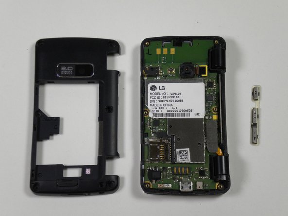

    • Before disassembling your phone, be sure it is powered off to avoid minor electric shock or possible fire.
    • Place the phone face down on the table.
    • Use your fingernail or an opening tool to pull down the tab below the battery.
    • Lift the battery out.
  2. LG env2 vx9100 Side Buttons Replacement, Back Panel: crwdns2935265:02crwdnd2935265:01crwdnd2935265:02crwdne2935265:0 LG env2 vx9100 Side Buttons Replacement, Back Panel: crwdns2935265:02crwdnd2935265:02crwdnd2935265:02crwdne2935265:0
    • Locate the five rubber covers on the back panel of the phone.
    • Use the metal probe to pop out each rubber cover to reveal the screws underneath.
  3. LG env2 vx9100 Side Buttons Replacement: crwdns2935265:03crwdnd2935265:01crwdnd2935265:02crwdne2935265:0 LG env2 vx9100 Side Buttons Replacement: crwdns2935265:03crwdnd2935265:02crwdnd2935265:02crwdne2935265:0
    • Locate the six 2.5mm screws on the back panel of the phone.
    • Use a #00 Phillips screwdriver to remove each 2.5mm screw.
  4. LG env2 vx9100 Side Buttons Replacement: crwdns2935265:04crwdnd2935265:01crwdnd2935265:02crwdne2935265:0 LG env2 vx9100 Side Buttons Replacement: crwdns2935265:04crwdnd2935265:02crwdnd2935265:02crwdne2935265:0
    • Locate the seam around the edge of the phone.
    • Insert the plastic opening tool into the seam and pry gently to release the tabs.
    • Work your way around the phone until all tabs are released.
    • Remove the back panel of the phone.
  5. LG env2 vx9100 Side Buttons Replacement, Side Buttons: crwdns2935265:05crwdnd2935265:01crwdnd2935265:02crwdne2935265:0 LG env2 vx9100 Side Buttons Replacement, Side Buttons: crwdns2935265:05crwdnd2935265:02crwdnd2935265:02crwdne2935265:0
    • Locate the volume and camera buttons on the right side of the phone.
    • Lift up on the buttons to slide them out of the phone.
