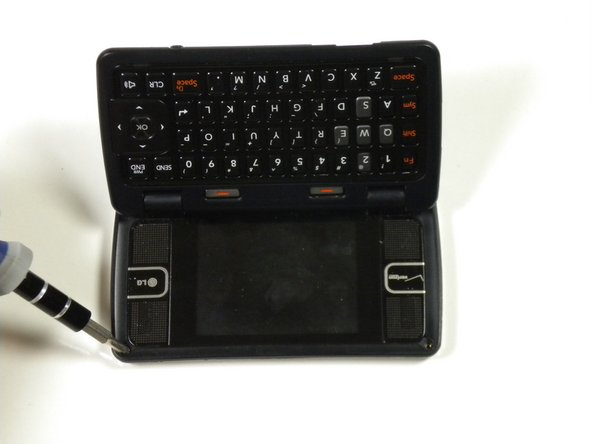

    3. LG env2 vx9100 Front Keyboard Replacement: crwdns2935265:07crwdnd2935265:01crwdnd2935265:02crwdne2935265:0 LG env2 vx9100 Front Keyboard Replacement: crwdns2935265:07crwdnd2935265:02crwdnd2935265:02crwdne2935265:0
      • Use a Phillips #00 screwdriver to remove two 2.5 mm screws.
      • These screws will not be visible or accessible unless the two sides of the phone are at approximately 90 degrees relative to each other.

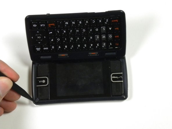

    4. LG env2 vx9100 Front Keyboard Replacement: crwdns2935265:08crwdnd2935265:01crwdnd2935265:02crwdne2935265:0 LG env2 vx9100 Front Keyboard Replacement: crwdns2935265:08crwdnd2935265:02crwdnd2935265:02crwdne2935265:0
      • Insert the plastic opening tool in the crease and move it along each edge of the phone.
      • Separate the front panel from the rest of the phone.
      • Be careful not to damage the orange ribbon that connects to the motherboard through the hinge in the phone. If the ribbon is damaged, the phone will not function properly.
      • Open the phone to reveal the inside monitor.

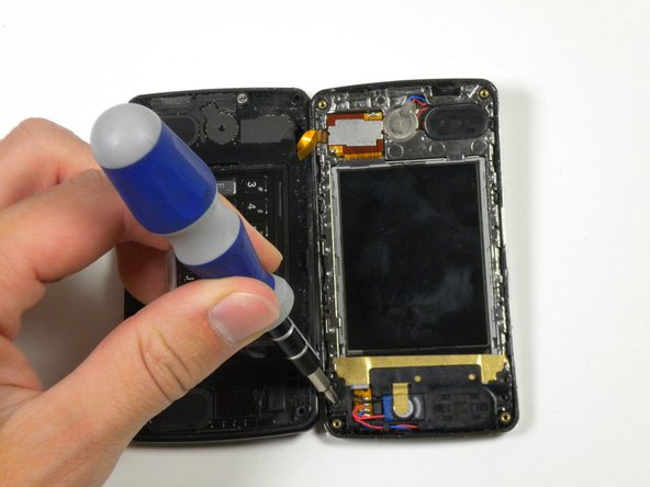

    5. LG env2 vx9100 Front Keyboard Replacement: crwdns2935265:09crwdnd2935265:01crwdnd2935265:03crwdne2935265:0 LG env2 vx9100 Front Keyboard Replacement: crwdns2935265:09crwdnd2935265:02crwdnd2935265:03crwdne2935265:0 LG env2 vx9100 Front Keyboard Replacement: crwdns2935265:09crwdnd2935265:03crwdnd2935265:03crwdne2935265:0
      • Use a Phillips #00 screwdriver to remove two 2.5mm screws.
      • Using your hands, separate the front panel from the phone by carefully pulling it straight off.

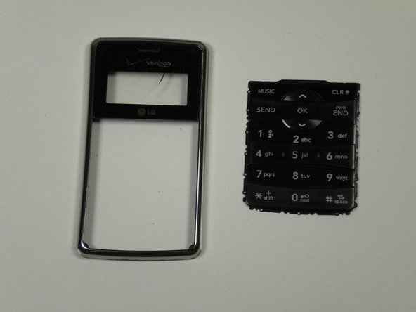

    1. LG env2 vx9100 Front Keyboard Replacement, Front Keyboard: crwdns2935265:010crwdnd2935265:01crwdnd2935265:02crwdne2935265:0 LG env2 vx9100 Front Keyboard Replacement, Front Keyboard: crwdns2935265:010crwdnd2935265:02crwdnd2935265:02crwdne2935265:0
      • Place the front panel so that the buttons face upwards.
      • Push on the buttons to remove the keyboard from the front cover.
