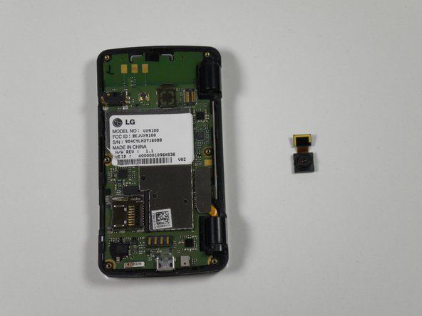

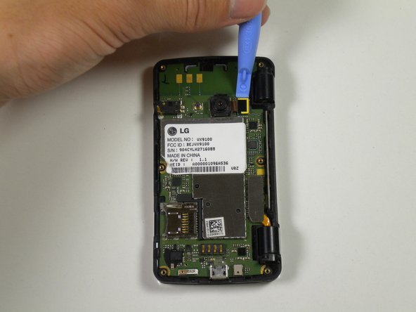

    1. LG env2 vx9100 Camera Replacement, Camera: crwdns2935265:05crwdnd2935265:01crwdnd2935265:02crwdne2935265:0 LG env2 vx9100 Camera Replacement, Camera: crwdns2935265:05crwdnd2935265:02crwdnd2935265:02crwdne2935265:0
      • Locate the ribbon attached to the lens of the camera.
      • Place the plastic opening tool in between the logic board and ribbon.
      • Lift up the plastic opening to detach the ribbon from the logic board.
    2. LG env2 vx9100 Camera Replacement: crwdns2935265:06crwdnd2935265:01crwdnd2935265:02crwdne2935265:0 LG env2 vx9100 Camera Replacement: crwdns2935265:06crwdnd2935265:02crwdnd2935265:02crwdne2935265:0
      • Place the plastic opening tool in between the lens and the logic board.
      • Detach the lens from the logic board using the plastic opening tool by popping it out.
      • Take the entire lens and ribbon off of the logic board.
