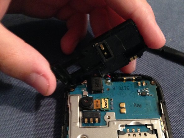

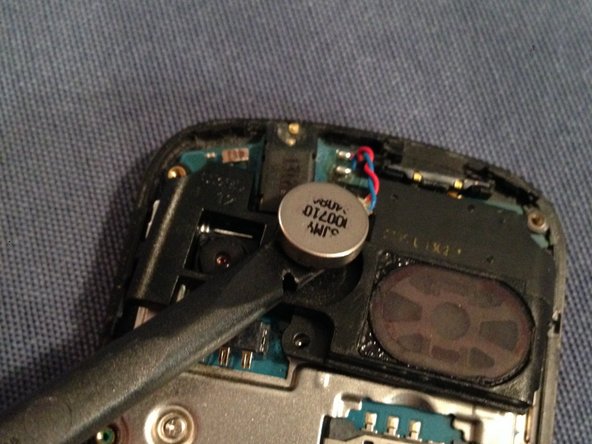

  3. LG Xpression C395 Teardown: crwdns2935265:03crwdnd2935265:01crwdnd2935265:03crwdne2935265:0 LG Xpression C395 Teardown: crwdns2935265:03crwdnd2935265:02crwdnd2935265:03crwdne2935265:0 LG Xpression C395 Teardown: crwdns2935265:03crwdnd2935265:03crwdnd2935265:03crwdne2935265:0
    • Take out the volume rocker daughter board, the black speaker plastic and the vibrate motor.

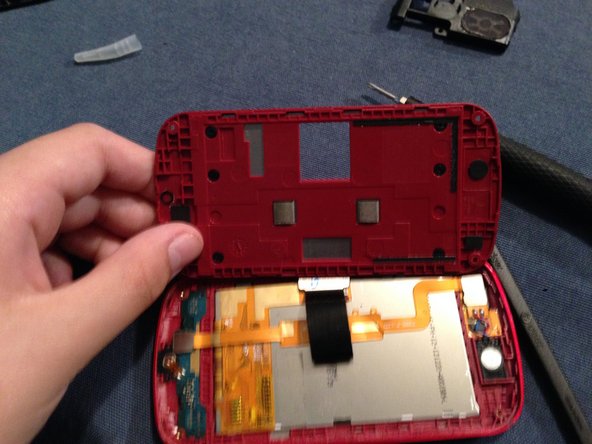

  7. LG Xpression C395 Teardown: crwdns2935265:07crwdnd2935265:01crwdnd2935265:02crwdne2935265:0 LG Xpression C395 Teardown: crwdns2935265:07crwdnd2935265:02crwdnd2935265:02crwdne2935265:0
    • Remove 4 more Phillips screws and remove the back of the screen

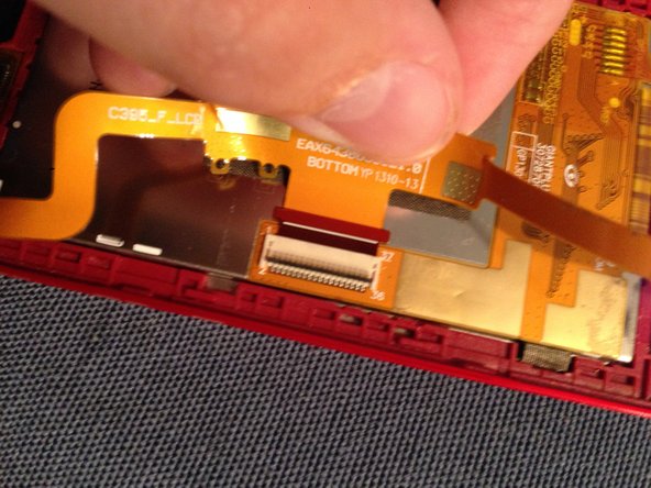

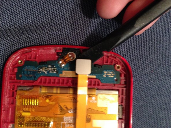

  8. LG Xpression C395 Teardown: crwdns2935265:08crwdnd2935265:01crwdnd2935265:03crwdne2935265:0 LG Xpression C395 Teardown: crwdns2935265:08crwdnd2935265:02crwdnd2935265:03crwdne2935265:0 LG Xpression C395 Teardown: crwdns2935265:08crwdnd2935265:03crwdnd2935265:03crwdne2935265:0
    • Remove the bottom button, earpiece and screen ribbon cable
