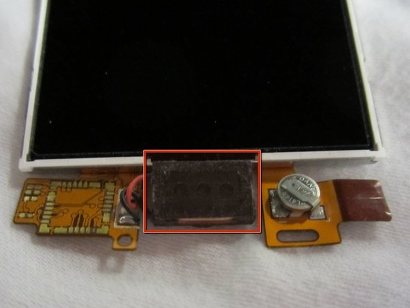

  19. LG Xenon Speaker Replacement, Speaker: crwdns2935265:019crwdnd2935265:01crwdnd2935265:02crwdne2935265:0 LG Xenon Speaker Replacement, Speaker: crwdns2935265:019crwdnd2935265:02crwdnd2935265:02crwdne2935265:0
    • The speaker is attached to the top of the LCD.
