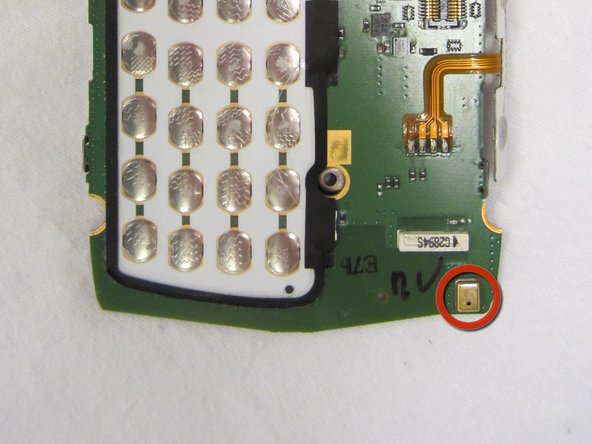

    1. LG Xenon Microphone Replacement, Microphone: crwdns2935265:011crwdnd2935265:01crwdnd2935265:02crwdne2935265:0 LG Xenon Microphone Replacement, Microphone: crwdns2935265:011crwdnd2935265:02crwdnd2935265:02crwdne2935265:0
      • The microphone is located on the bottom corner of the motherboard.
      • Take caution when repairing the microphone to not damage the motherboard.
