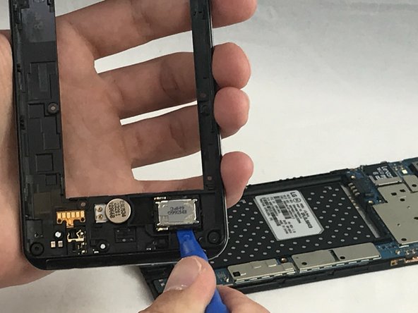

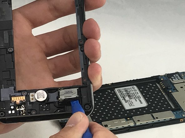

  5. LG X Style Speaker  Replacement, Speaker: crwdns2935265:05crwdnd2935265:01crwdnd2935265:03crwdne2935265:0 LG X Style Speaker  Replacement, Speaker: crwdns2935265:05crwdnd2935265:02crwdnd2935265:03crwdne2935265:0 LG X Style Speaker  Replacement, Speaker: crwdns2935265:05crwdnd2935265:03crwdnd2935265:03crwdne2935265:0
    • Insert the plastic opening tool into slit around speaker box on mid shield frame.
    • Gently pop up the speaker housing.
    • If the adhesive film doesn’t remove itself with the speaker housing, use the plastic opening tool to remove film.
