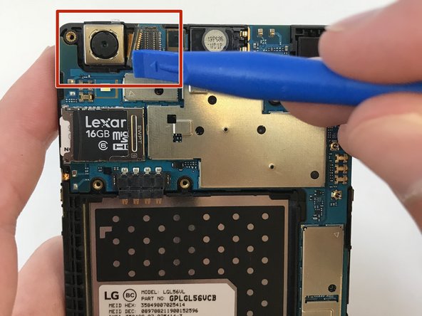

  5. LG X Style Rear Facing Camera  Replacement, Rear Facing Camera: crwdns2935265:05crwdnd2935265:01crwdnd2935265:02crwdne2935265:0 LG X Style Rear Facing Camera  Replacement, Rear Facing Camera: crwdns2935265:05crwdnd2935265:02crwdnd2935265:02crwdne2935265:0
    • Gently use the plastic opening tool to pinch off camera connection tab from motherboard.
  6. LG X Style Rear Facing Camera  Replacement: crwdns2935265:06crwdnd2935265:01crwdnd2935265:01crwdne2935265:0
    • With the plastic opening tool, gently lift up camera housing and remove.
