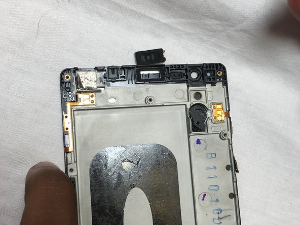

  9. LG X Power Screen Replacement (with Frame): crwdns2935265:09crwdnd2935265:01crwdnd2935265:02crwdne2935265:0 LG X Power Screen Replacement (with Frame): crwdns2935265:09crwdnd2935265:02crwdnd2935265:02crwdne2935265:0
    • Using the plastic opening tool, pry off the ear speaker.

If you are just replacing the screen, this is wrong. This would help if you are replacing with a “screen in frame”
asears - crwdns2934203:0crwdne2934203:0
What is the right way for just the screen?
Kodi Butscha -
Please add “with frame” in title. Also need to make sure all contacts are present on the frame of the new screen, transfer them over if not.
rian_bay - crwdns2934203:0crwdne2934203:0
Is the x power screen the same size ( or same screen altogether) as the x power 3 screen? If not what screen would I be looking for?
Jonathan - crwdns2934203:0crwdne2934203:0
Where’s the part where you actually remove the screen and add in the new one?
The last step seems to be prying off the ear speaker.
Could you please fix this guide when you get the chance? I might replace the screen on my LG Power X [K210]. Thanks.
