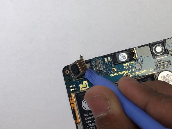

  4. LG X Power Charging Port Replacement, Charging Port: crwdns2935265:04crwdnd2935265:01crwdnd2935265:03crwdne2935265:0 LG X Power Charging Port Replacement, Charging Port: crwdns2935265:04crwdnd2935265:02crwdnd2935265:03crwdne2935265:0 LG X Power Charging Port Replacement, Charging Port: crwdns2935265:04crwdnd2935265:03crwdnd2935265:03crwdne2935265:0
    • Use the flat end of a spudger to disconnect the front and rear cameras from the motherboard.
    • Pull the cameras out to remove them.

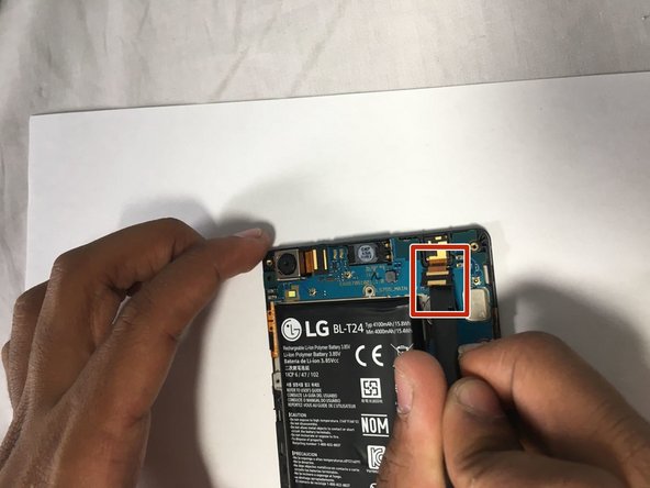

  5. LG X Power Charging Port Replacement: crwdns2935265:05crwdnd2935265:01crwdnd2935265:01crwdne2935265:0
    • Use the flat end of a spudger to disconnect the battery from the motherboard.
    • You will not be removing anything, just disconnecting.
