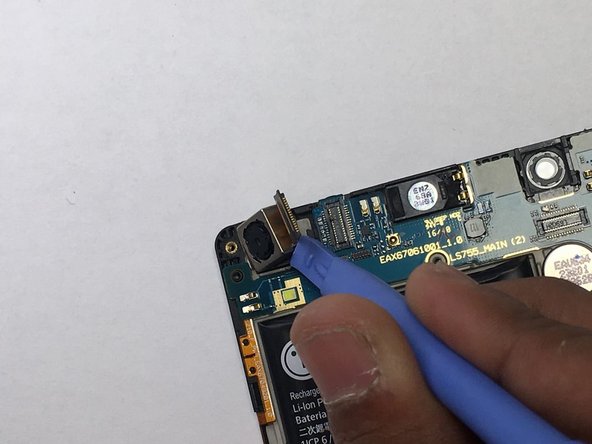

  4. LG X Power Camera Replacement, Main Camera: crwdns2935265:04crwdnd2935265:01crwdnd2935265:02crwdne2935265:0 LG X Power Camera Replacement, Main Camera: crwdns2935265:04crwdnd2935265:02crwdnd2935265:02crwdne2935265:0
    • Use the flat end of a spudger to disconnect the front and rear cameras from the motherboard.
    • Pull the cameras out to remove them.
