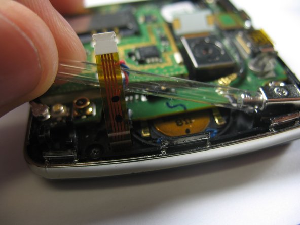

  7. LG Vu CU920 Speaker Replacement: crwdns2935265:07crwdnd2935265:01crwdnd2935265:01crwdne2935265:0
    • Use a spudger to disconnect the cables from the motherboard.
    • The following steps will detail how to detach the cables from the connectors.
  8. LG Vu CU920 Speaker Replacement: crwdns2935265:08crwdnd2935265:01crwdnd2935265:03crwdne2935265:0 LG Vu CU920 Speaker Replacement: crwdns2935265:08crwdnd2935265:02crwdnd2935265:03crwdne2935265:0 LG Vu CU920 Speaker Replacement: crwdns2935265:08crwdnd2935265:03crwdnd2935265:03crwdne2935265:0
    • Gently lift the ZIF connector (black tab) holding the ribbon cable in place. When it is in the upright position, remove the cable from the back side.

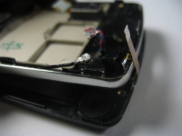

  13. LG Vu CU920 Speaker Replacement, Bezel and External Casing: crwdns2935265:013crwdnd2935265:01crwdnd2935265:02crwdne2935265:0 LG Vu CU920 Speaker Replacement, Bezel and External Casing: crwdns2935265:013crwdnd2935265:02crwdnd2935265:02crwdne2935265:0
    • Remove the 3.5mm screw holding the antenna guide in place with a Philips #00 screwdriver.
    • Slide the antenna out to the edge, and remove the plastic tubing by gently pulling it out from the opposite end of the antenna.
    • This step can be done after the motherboard is removed, or before (as photographed).

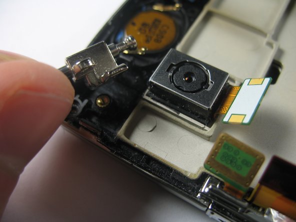

  14. LG Vu CU920 Speaker Replacement: crwdns2935265:014crwdnd2935265:01crwdnd2935265:02crwdne2935265:0 LG Vu CU920 Speaker Replacement: crwdns2935265:014crwdnd2935265:02crwdnd2935265:02crwdne2935265:0
    • Use a plastic opening tool to carefully pry up the metal antenna guide.

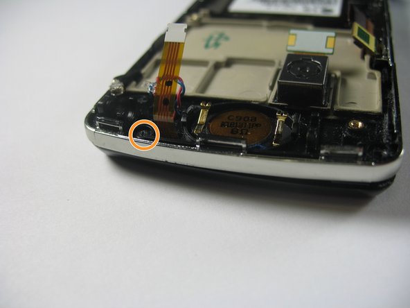

  15. LG Vu CU920 Speaker Replacement: crwdns2935265:015crwdnd2935265:01crwdnd2935265:02crwdne2935265:0 LG Vu CU920 Speaker Replacement: crwdns2935265:015crwdnd2935265:02crwdnd2935265:02crwdne2935265:0
    • Using a Philips #00 screwdriver, remove the two 3.5mm screws on the bottom corners of the device.
    • Remove the single 3.5mm screw located at the top next to the speaker's ribbon cable.

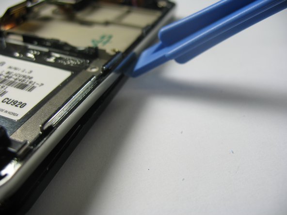

  16. LG Vu CU920 Speaker Replacement: crwdns2935265:016crwdnd2935265:01crwdnd2935265:03crwdne2935265:0 LG Vu CU920 Speaker Replacement: crwdns2935265:016crwdnd2935265:02crwdnd2935265:03crwdne2935265:0 LG Vu CU920 Speaker Replacement: crwdns2935265:016crwdnd2935265:03crwdnd2935265:03crwdne2935265:0
    • Insert a plastic opening tool below the volume rocker and gently pry the silver casing up. As with the plastic casing over the motherboard, you should be able to slide the plastic opening tool along the edge to remove it.
