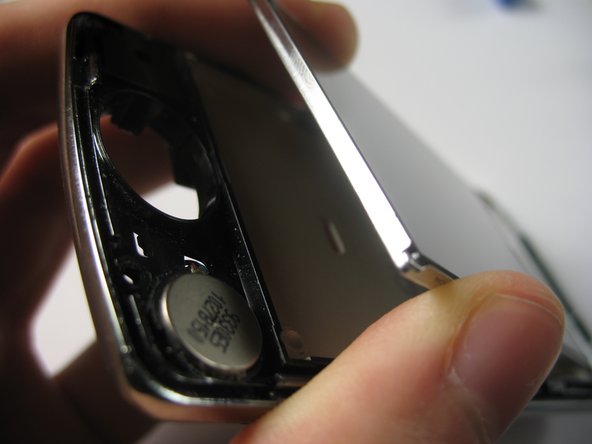

    4. LG Vu CU920 LCD Screen Replacement: crwdns2935265:016crwdnd2935265:01crwdnd2935265:03crwdne2935265:0 LG Vu CU920 LCD Screen Replacement: crwdns2935265:016crwdnd2935265:02crwdnd2935265:03crwdne2935265:0 LG Vu CU920 LCD Screen Replacement: crwdns2935265:016crwdnd2935265:03crwdnd2935265:03crwdne2935265:0
      • Insert a plastic opening tool below the volume rocker and gently pry the silver casing up. As with the plastic casing over the motherboard, you should be able to slide the plastic opening tool along the edge to remove it.

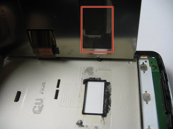

    1. LG Vu CU920 LCD Screen Replacement, LCD Screen: crwdns2935265:017crwdnd2935265:01crwdnd2935265:03crwdne2935265:0 LG Vu CU920 LCD Screen Replacement, LCD Screen: crwdns2935265:017crwdnd2935265:02crwdnd2935265:03crwdne2935265:0 LG Vu CU920 LCD Screen Replacement, LCD Screen: crwdns2935265:017crwdnd2935265:03crwdnd2935265:03crwdne2935265:0
      • After separating the front casing from the mid frame, begin prying the screen out.
      • The screen is attached to the midframe with a small piece of adhesive.
      • Use a plastic opening tool to completely remove the screen.
