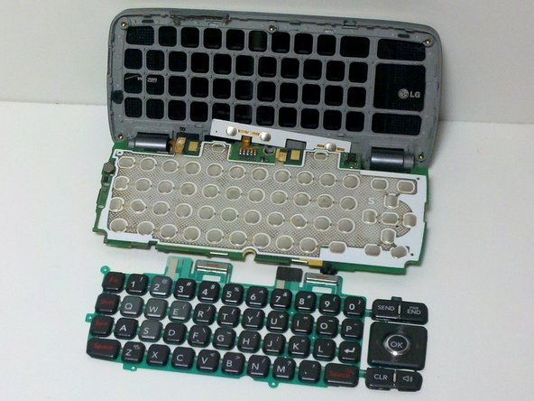

    • Power off your phone.
    • Turn your phone so that the bottom is facing upwards.
    • Remove all four screw covers and screws from the back of the phone with the Phillips #00 screwdriver.
  2. LG Voyager Keypad Replacement: crwdns2935265:02crwdnd2935265:01crwdnd2935265:02crwdne2935265:0 LG Voyager Keypad Replacement: crwdns2935265:02crwdnd2935265:02crwdnd2935265:02crwdne2935265:0
    • Gently pry open the back of the keyboard.
  3. LG Voyager Keypad Replacement: crwdns2935265:03crwdnd2935265:01crwdnd2935265:02crwdne2935265:0 LG Voyager Keypad Replacement: crwdns2935265:03crwdnd2935265:02crwdnd2935265:02crwdne2935265:0
    • Pull the rubber keyboard off carefully.
    • Be sure not to remove the silver button panel below the keyboard.
