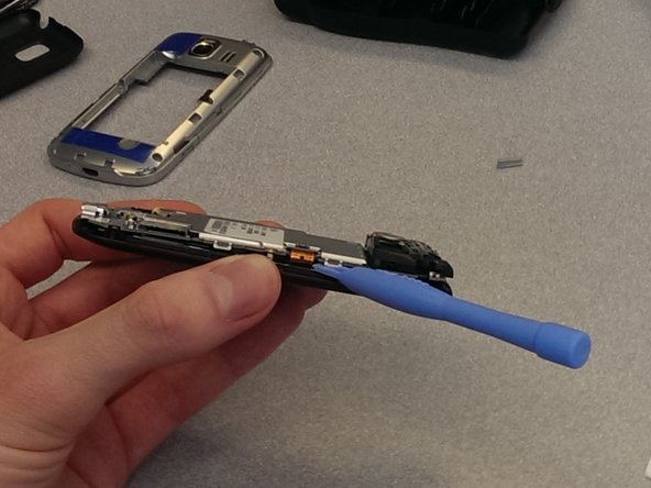

    • Use the blue plastic opening tool to remove the back frame from the rest of the phone.
    • Pry at the micro SD slot. Push the cover for the SD slot away from the front of the phone and pry the back frame away from the rest of the phone.
    • Pry your way around the entire phone to separate the face from the frame.

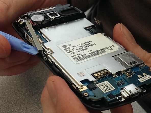

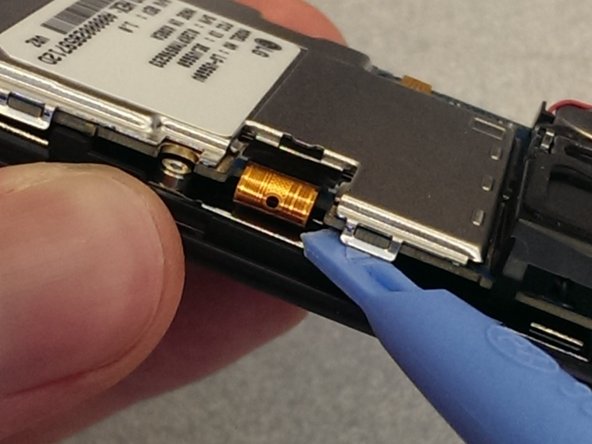

    • Unclip the screen connector that is connecting the screen to the system board. It is on the right side of the phone, and looks like a thin piece of bronze plastic.
    • Be gentle.

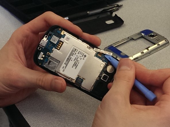

    • Pull the volume button away from the case and set aside. It is located on the left side of the phone, and is held to the frame by a small nub.
  8. LG Vortex Screen Replacement: crwdns2935265:08crwdnd2935265:01crwdnd2935265:01crwdne2935265:0
    • Pull the white piece underneath the volume button away from the frame.

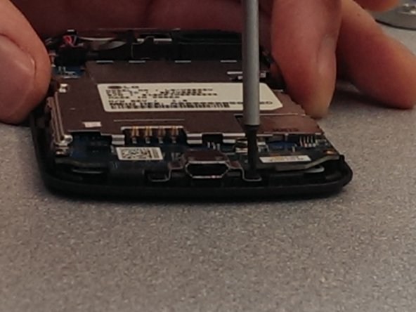

  9. LG Vortex Screen Replacement: crwdns2935265:09crwdnd2935265:01crwdnd2935265:02crwdne2935265:0 LG Vortex Screen Replacement: crwdns2935265:09crwdnd2935265:02crwdnd2935265:02crwdne2935265:0
    • Unscrew the two short black screws at the bottom of the phone, which are holding the USB port to the frame.
    • Place the screws in a safe place
  10. LG Vortex Screen Replacement: crwdns2935265:010crwdnd2935265:01crwdnd2935265:03crwdne2935265:0 LG Vortex Screen Replacement: crwdns2935265:010crwdnd2935265:02crwdnd2935265:03crwdne2935265:0 LG Vortex Screen Replacement: crwdns2935265:010crwdnd2935265:03crwdnd2935265:03crwdne2935265:0

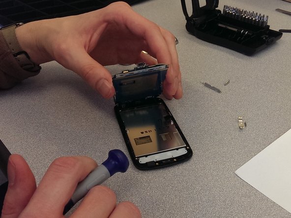

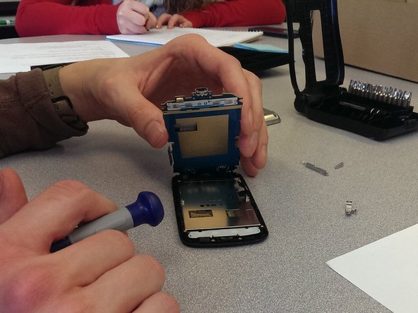

    • Lift the system board up and away from the front screen
    • Caution! Perform this step slowly, because the two pieces will still be attached at the top of the phone.
